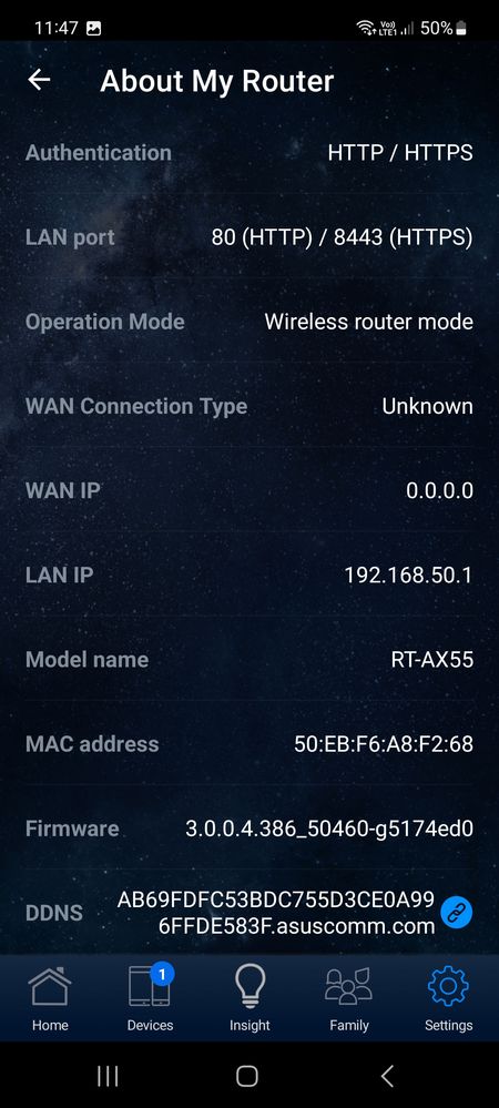

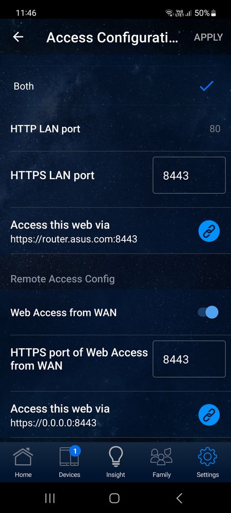

Thanks for the response. As you've seen I've been following the advice on the thread but I still cannot connect. I have done a screen grab of the Asus modem as below. hopefully there's a clue there but whatever, I don't seem to have the ability (more likely I just cant find it) of how to make any amendments.
I am definitely a 'plug and play' sorta guy 🙂
Screenshot_20221231_114604_ASUS Router (002).jpgScreenshot_20221231_114710_ASUS Router (002).jpg

Assuming the Hub 1 is still on its default settings,
Change the ax55  lan ip to 192.168.1.1
Then change to access point mode, connect via  a lan port to the Hub 1
You should then be able to access the ax55 vusing 192.168.1.1
