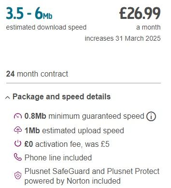

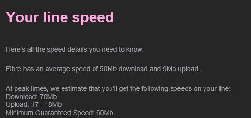

Speed Promise has change since order
I placed an order on the 15th with a promise min download speed of 50 but now on the website that has changed to 0.8
I do not think its worth me carrying on with the contract if this is the case as our wireless broadband would be faster.

@L0rdMike  You need to contact Plusnet as it looks like they have ordered the wrong product.☹️ Those slower speeds could be for an ADSL service so do not apply to a "Fibre" (FTTC or SOGEA) connection.

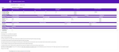

@L0rdMike
Can you post a screen image of the results from the following after hiding your details.
To post a screen image click on the Image.JPGicon above the text reply box.

@L0rdMike
Thanks for the information.
While you should get between 57.2 - 77 down on a FTTC connection the problem with your order is shown to the right where it says "Waiting List"
This means there is no capacity at the Cabinet so PN can't place your order - they appear to have provisioned you on an ADSL connection to keep you going.
Are you moving to PN or were you trying to upgrade.

When I placed the order it showed 77 on the website, is it possible I have taken the last space in the cabinet or have they quoted me the max speed with a full cabinet?
Have they ? or was there availability at the time of the order and so OR accepted it but now there is no more capacity ?
@L0rdMike I suggest you call customer services to check whether your order has been accepted

@L0rdMike
It's entirley possible that  when you ran the enquiry there was a port available but in between you running the enquiry, placing the order and then PN attempting to place it with OR someone else jumped in and got the slot.
Are you moving ISP? If so, that will create a port when you move but once again someone else may jump in first.
