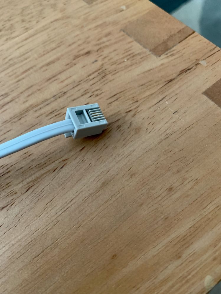

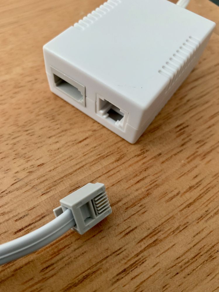

Re: Moving Home will Router just work ?
@John_1927 What is on the other end of the blue cable in picture 1?
John_1927
Posts: 18
Thanks: 6
Registered: ‎14-04-2020
jab1 it's the same - the cable that came with the router.
You need the other cable which came with the router!

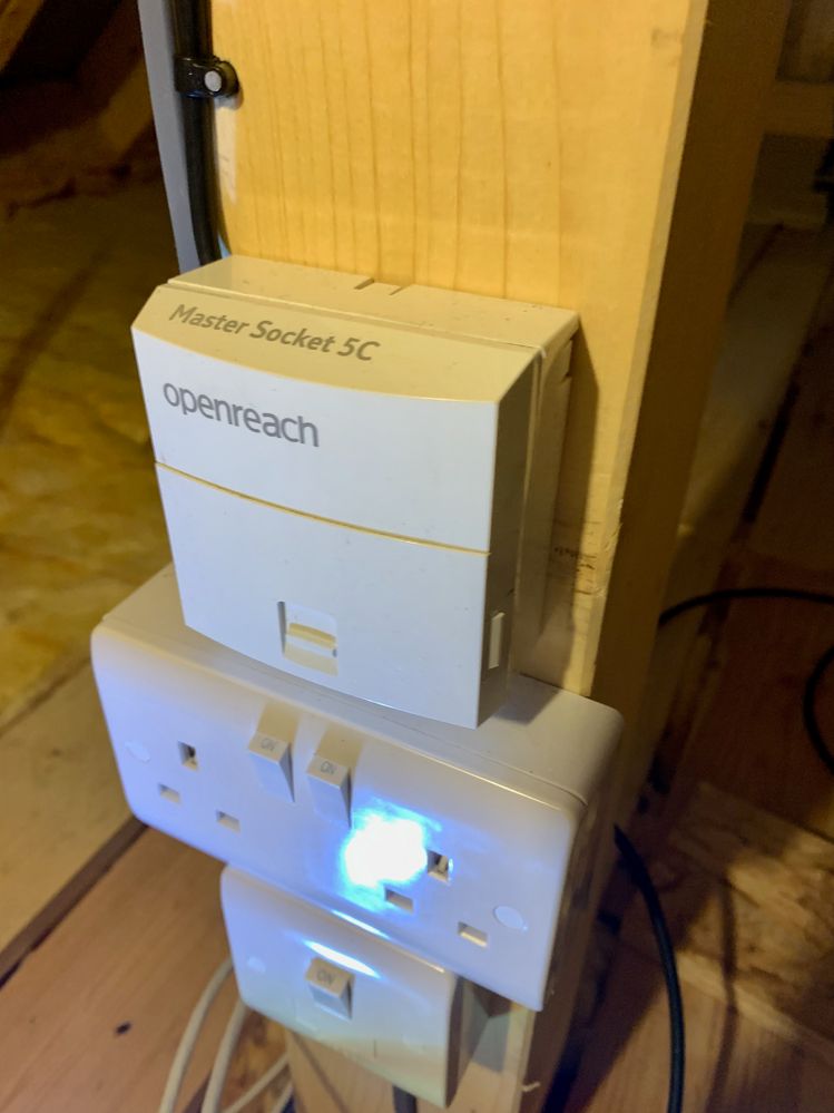

The phone line is now connected Plusnet say - the service is Unlimited Fibre Extra just as I was on at the old house. There is NO - FTTP in this area as yet.
More photos from in the loft soon.

That being the case, the router is going to need to be installed in the loft where the circuit comes in.
This is starting to sound as though the house has been wired throughout with CAT5/5a/6 ethernet cabling. The router needs to go wherever all of that cabling comes together.
If that is the case, then you would expect it all, including the BT master socket, to be in a utility cupboard somewhere (rather than the loft) ?Huh
So there it is in the roof - nearby are two data cables and the aerial cables - not connected. So I could put the router in the loft space - but not too happy about that.
Not the best of set-ups - are there extensions around the house for the voice side of the service?
Have you put a telephone hand set into that socket to see if the line is live?
If BT have yet to attend site, you could ask them to but a new socket (on a new "drop" wire) where it suits you best.  Will require a hole through somewhere.
Yes the line is live calls incoming. Broadband is not on yet.
"are there extensions around the house for the voice side of the service?"
No - only the two data ones as shown in photos.
So what to do ? Ive put the cordless base station in the roof that's solved that - (temp)
You could use one of the data cables, Im assuming they're cat5. Replace one of the wall plates with a phone extension plate or box. If you can detemine the manufacturer of the wall plate your should be able to get a phone socket to replace the RJ45 insert. Then use a single pair of the data cable to connect the extension to the master socket.
Yes, ideally the router shouldnt be connected at an extension but the data cable is cat5 quality so shouldnt be a problem.
