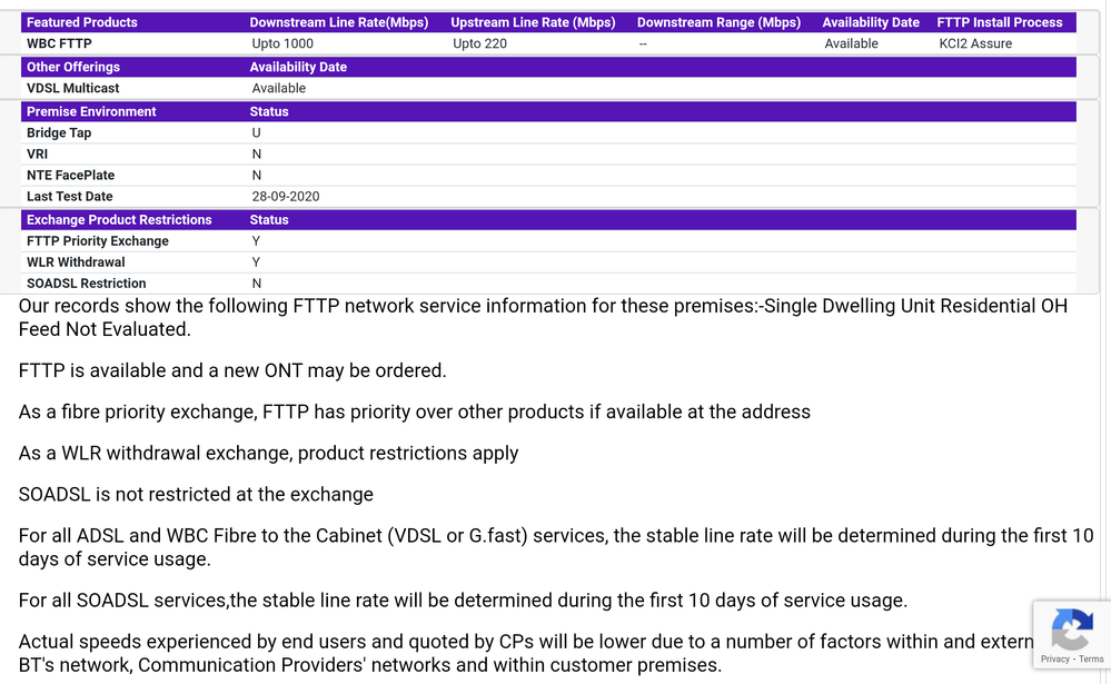

You checker results show install process as KCI2 Assure, which means that Openreach will survey first ( within 5 days I believe) to establish exactly what work is needed for an FTTP install. Only then will they commit to an install date. It's odd to see that for an o/h Feed ? Normally that's a 1-Stage as its just install a new o/h fibre feed. Is there any odd issues with cable routing ?

I forgot about the column to the right. As requested by @MisterW  are there any line of sight issues, access problems or anything else you think might interupt an install?

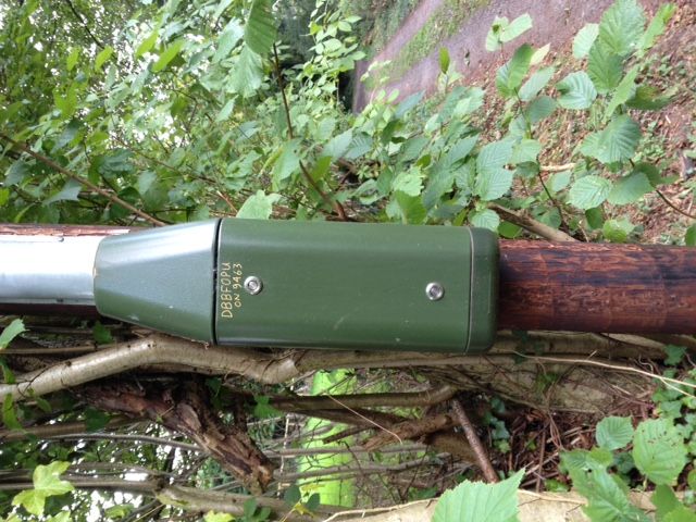

Thanks. The area has had FTTP for quite a few years, this is what's on the pole on the lane leading to the house. The existing (copper) phone line is overhead, not sure if it comes from this exact pole or whether there's an intermediate. Would they run the aerial fibre on the same pole as copper?

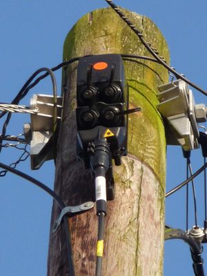

Is there something at the top of the pole that looks like this
This is a 4 port Customer (Connector?) Block Terminal (CBT) though they can go up to 12 port (at least). The fibre cable can replace the copper or run along side the copper. In years gone place they used a hybrid fibre/copper cable but that was before they stopped selling copper services.

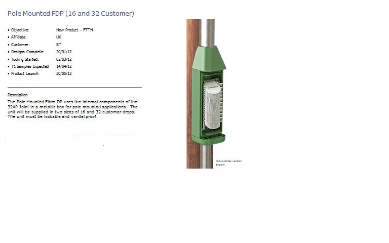

Nothing like that as far as I can recall.  It looks like all cables come to and from that green box which is about shoulder height on the pole. Looking elsewhere suggests it's one of these ...

I don't know but this looks like it could be an old fashioned 2 Stage install. A cable is run from this box to a CSP on your property which needs to be fused (joined) at both ends. Current installs have a pre-connected cable which just plugs into the unit I previously showed and fused at the CSP to the internal cable.
OR probably need to just look at the box and the line of sight to your property to confirm everything is straight forward. If so, there should be little delay.
They could proably do the survey without anyone present so long as there's no access issues.
