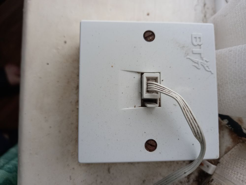

Thank you for the replies. I think our master socket is an NTE5, installed around 1985. It has a single outlet with a BT style plug on it. There is no extension wiring. We have a long cable between the master socket and the DSL router which has a BT style plug at the master socket and the small plastic plug at the router end. This cable is between 5 and 10 metres long. i have taken a photo of the master socket but i have been unable to figure out how to upload it here.

Posts: 25,167
Thanks: 9,095
Fixes: 387
Re: Does SOGEA FTTC need a microfilter?
@sn5775 If you are using a laptop/desktop click the icon next to the right of the smiley face and follow instructions, if you are using a phone/tablet,select 'request desktop site' and then do as above.
@sn5775 use the 'Insert photos' icon ( just to the left of the video camera icon )
My guess that this is a BT plug to RJ11 cable but a picture of this would also be useful.
If I'm correct, then I assume you arent currently using a filter ?
I have reservations about the use of a long cable, they are often not good quality and can affect the speeds

Posts: 20,238
Thanks: 9,143
Fixes: 583
@sn5775 uugh! that cable doesnt look too good, its not twisted pair or screened.
Its probably not affecting your ADSL speed too much but MAY impact the performance of a SoGEA connectio

I've just had a look at cabling. The BT master socket and the router are on opposite sides of the room. there is a short extension cable leading from the master socket approximately 2 meters which is the one that @MisterW is referring to. then there is an ADSL filter, into which our landline is connected alongside the long cable approximately 5 metres to the ADSL router.
We are seriously considering placing the new router directly next to the master socket.
