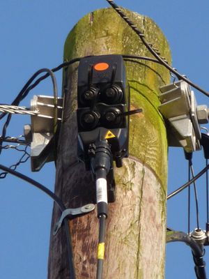

Pole-fed FTTC, good point.. it does look like there is a splitter on it. How to tell if its a fibre one? Cheesy
Posts: 4,981
Thanks: 1,790
Fixes: 87
Re: Mixed Messages On Full Fibre Availability
@Phantom
The unit is called a Customer Block Terminal (CBT). The pictures show both an underground and overhead CBT. The number of ports depends on the number of properties the pole serves.
There could be two reasons why FTTP is not yet available. One, the circuit for the pole has not yet been commissioned (perhaps a fault was found in testing). Or there is a database error so your house isn't showing as available.
Using the address version of the Checker look at all the properties served by the pole. You want to see WBC FTTP in the left hand column and Available to the right.

@bmc wrote:
@Phantom
Or even 'Connectorised Block Terminal'. Smiley
