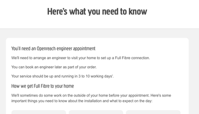

3 . This will bring up what packages are available for your postcode, so please then select desired speed package.
4. You will then get a message from Plusnet saying there's an working phone line at your address, what would you like to do with it.
If you wish to keep your existing number for transfer later, please select need my existing phone line with my current provider.
5. This is where you'll setup your new Plusnet account by filling in your details, creating a new username login and password, and use a different email address to your existing login, and then select your desired Openreach engineer installation date.
I selected a morning appointment (8am-1pm) but the engineer didn't get to me until 1.30pm, so probably best to allow all day, as full fibre installs can take 2-4 hours in some cases, and it all depends on the engineers other appointments before you.
Once everything is filled in review your order and submit, you should then receive confirmation emails of your order, and a separate email confirming your selected engineer appointment is available
