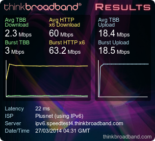

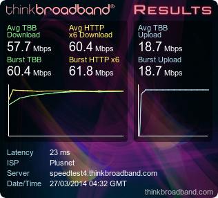

Noticed youtube videos crawling along (youtube is ipv6 enabled).
Did some speedtests and here is results (note I repeated the ipv6 test multiple times to confirm and its 4.30am).
ipv6
ipv4
The huge gap between x6 and normal is bizarre but the single threaded result is bang on to youtube throughput.

So I will continue to update even tho noone has shown interest (testers and staff alike).
TBB single threaded tests continue to max out at around 3mbit./sec.
youtube is not consistent its usually 3mbit/sec throughput but sometimes is line speed.  So I am thinking now either plusnet are testing traffic management with some routes rate limited, or there is an issue on some ipv6 routes.
Need others to test and staff to respond really.

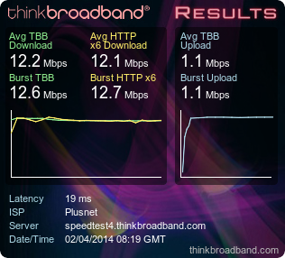

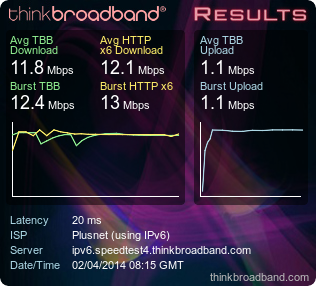

As requested. Both results were carried out using the ipv6test account. I disabled IPv6 in the network properties of the adapter to get the IPv4 result.
IPv6
IPv4
