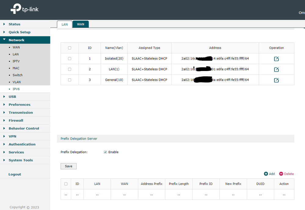

Re: IPv6 on a TP-Link ER605 router
Here's a screenshot of my IPv6 LAN page after configuration.
@IMM
Thanks for that, all working now, but only one WAN at a time.
