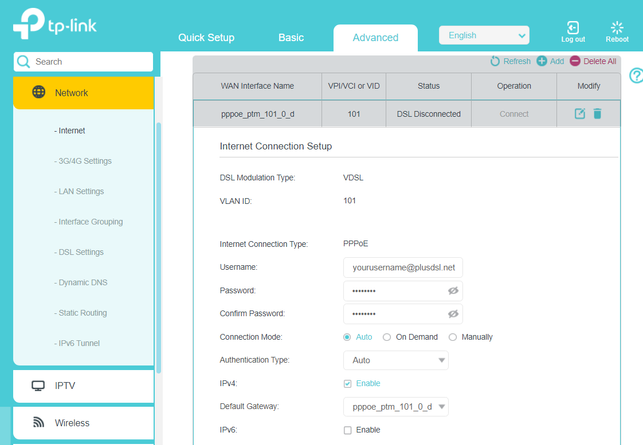

Yes you might have DSL but a little thinking at what you are viewing in the GUI I would hope you would be able to work out the default gateway would be the modem of the VR400 and not the WAN port.
I expect you see the above, Enable IPv6.
Try making the IPv6 Default Gateway to be the same as the IPv4***
EDIT: I'll switch my VR400 on later to see what the DSL config looks like, can't test it as I am Full Fibre
*** My VR400 shows the options as use Current Connection

I hadn't edited the connection screen, and am relieved to say that I now have IPv6 back up and running.
Thanks for your help.
