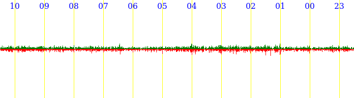

@MPC looks like it was like BTWholesale or Openreach maintenance work that affected you last night. There were a number of customers that were disconnected all at the exact same time and all connected to the same router within the BTWholesale network and were down for just under 15 minutes. Annoyingly I can't find the report that tells me who was affected by maintenance work but I'm 99% certain that's what it was.

outcast
Aspiring Champion
Posts: 961
Thanks: 393
Fixes: 19
Registered: ‎11-01-2025
Re: IPv6 Trial Update
If that was the case, it wasn't seen on A&A's network.
A&A have a real time scrolling monitor of network logins and logouts, great for identifying BTWholesale router dropouts.
As you can see below (from this morning) there was nothing unusual going on -
This shows the last 12 hours of logins and logouts. The current time on left. Green is login. Red is logout. If there are spikes, then this shows a large number of logouts or logins.
