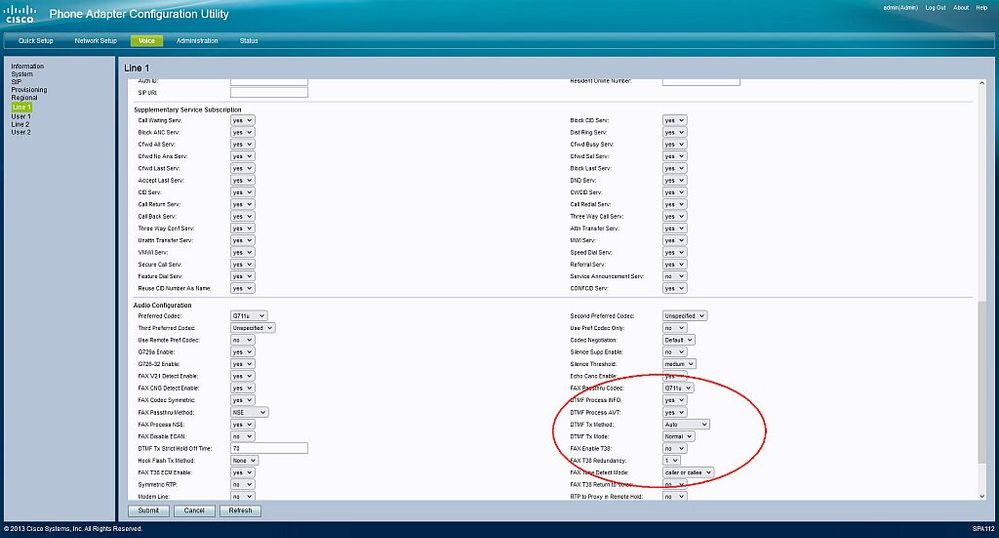

@MisterW wrote:
he only consistent issue is that the phone is much more prone to misdialling. Unless you leave a short pause between each button press there is a high chance that the call won't work.
@JSHarris it might be worth experimenting with changing the DTMF Tx Mode setting from Strict to Normal and see if that makes any difference
Thanks, I'll give that a try (once I've discovered where that setting is!).  I'll report back if that does indeed fix the misdialling issue.

@JSHarris  i dont have a Cisco ATA but I believe its in the Line 1 & Line 2 settings

For the Cisco SPA112 I have it's in the "Voice" menu option, towards the bottom at the right.  I've changed DTMF Tx from "Strict" to "Normal", so will see what happens.  Screenshot in case this may help someone else with a Cisco ATA:

Just an update and thanks again to @MisterW , as changing the DTMF Tx setting to normal does seem to have resolved the somewhat hit and miss dialling I was getting before.
