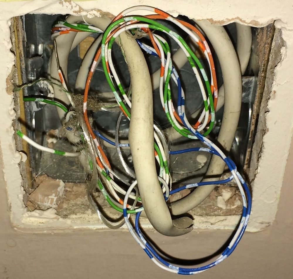

I've also noticed a blank plate attached to the wall of my hallway. I took the blanking plate off and found what looks to me like a bunch of telephone wires. I've attached a photo to show what I've found, and would be grateful if you, or anyone else can tell me what you think.

I would guess that at some point in the past the Master socket has been moved from the hall. The wiring doesn't look that great so there is scope for a bad joint.

Thanks for the reply Brian. When you say the wiring doesn't look that good, did you mean the wiring in the last picture I posted? If so, then this is the wiring found in the hallway and that is not in use, its not the wiring that goes to my phone socket.

If you have what looks like a BT80 socket right at your front door are you sure the cable doesn't go from there to the socket in your hall and then onto your master socket?

I can't see any crimps or joints in that second picture.  Think this might be redundant.
