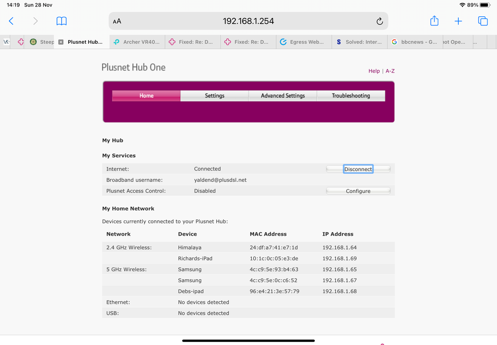

Hi Bob, sadly still dropping constantly. I did the 192. Address thingy and it was interesting in that hubby’s ipad is on 2.4 and mine on 5. His doesn’t seem to drop.C366FF89-EA62-4C77-9DE1-BEC905F908FD.png

Sorry that hasn't worked @Debs59 😪. Bob will know more about the  wireless thing than me, but have you tried getting your iPad to 'forget' the network and then rescanning? Apple devices have some really quirky habits.

I suspect that the older iPad has an old wireless adapter and can only see the 2.4 GHz band. Whereas the new iPad can see both bands. Why that should cause a problem and how to get round it is what we are trying to solve.
@Debs59
Just to check one other thing. Does your newer iPad drop out when it is close to the Hub? In other words, this isn't just a signal strength issue? My understanding is that the 5 GHz signal doesn't carry as far as the 2.4 GHz signal.
If rescanning - as suggested by @jab1 doesn't work - try splitting the bands as suggested earlier in this thread. We have been told that it shouldn't be necessary with the new firmware but doing so could either solve your problem by itself (if that advice was wrong) or give a further option to try.
If splitting the bands doesn't work, you could try turning off the 5 GHz band. Either at the Hub or - and this may be easier to do - by forgetting the 5 GHz band on the iPad. You wouldn't be able to use this "forget" trick until you have split the bands.
