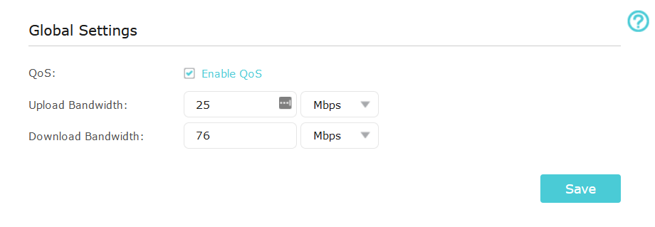

Thanks for taking the time to respond.  I had already looked at the QoS setting and download and upload were set to 1000mbps, it would seem this is therefore not the cause.
If QoS is enabled then those values need to be be changed to the actual download and upload bandwidth NOT 1000mbps.

Changed them to a more realistic value and deactivated the built in firewall. Alas, still not sorted, used 4g to have what's app video call, no issue. Tried ethernet and wireless and freezing back.

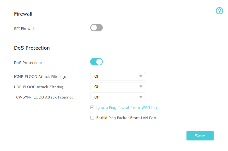

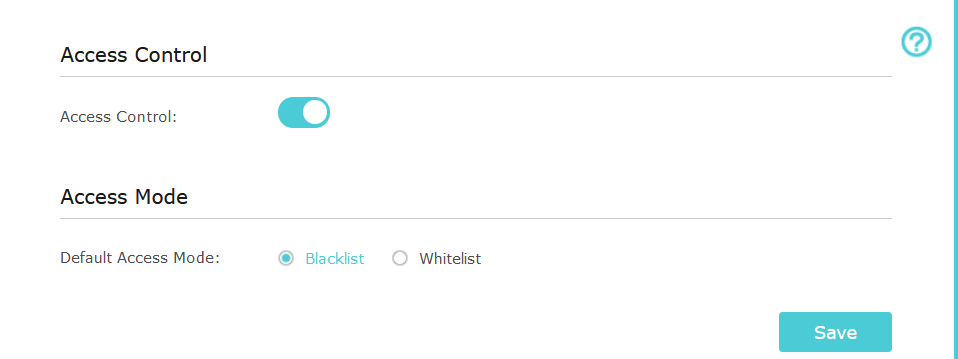

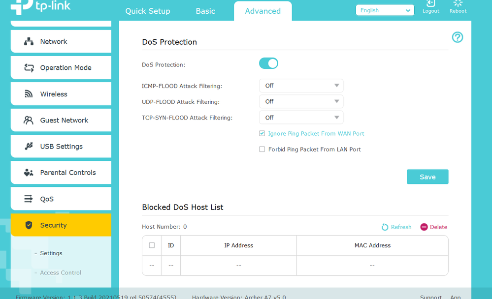

Post the version of your Archer C7, as there are 5 of them and each differs in terms of options. Otherwise it'll be difficult to know and everyone on here is second guessing. You'll find the hardware version on the label on the router.
Do you have the Archer set up as 'Access Point'?
Have you got the latest firmware?
It'd also be helpful if you posted some screenshots from your router's firewall settings. (I'm using Archer emulator for hardware V3):
- post screenshots of your settings under 'Security', more specifically 'Basic security' and 'Advanced security'.(You could experiment with ALG settings)
- post screenshots from under the 'Bandwidth control' tab

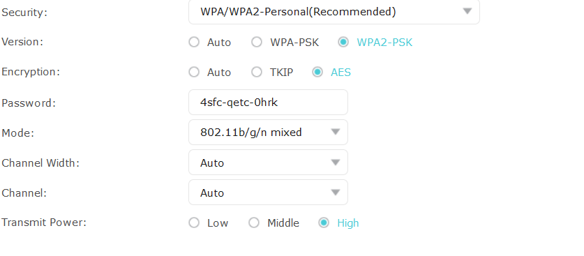

Here are the screenshots, not sure if they are the correct ones.  The 2.4 and 5 ghz channels are in auto but channel 2 is 2.4 and 36 is 5ghz.  I have read that 1 and 10 are better for 2.4 but unsure of changing that will make a difference.

Try the following. One at a time. If unsuccessful, switch the setting back on to how it was before you changed it:
- if you're connecting the Archer directly to your BT Hub, then change the setting to 'Access Point', then test
- switch QoS off (untick the box), then test (this function won't matter if Archer is in the Access Point mode anyway)
- switch Access Control off (disable), then test
- finally, switch DoS protection off and then test
Your problem has nothing to do with the WiFi
