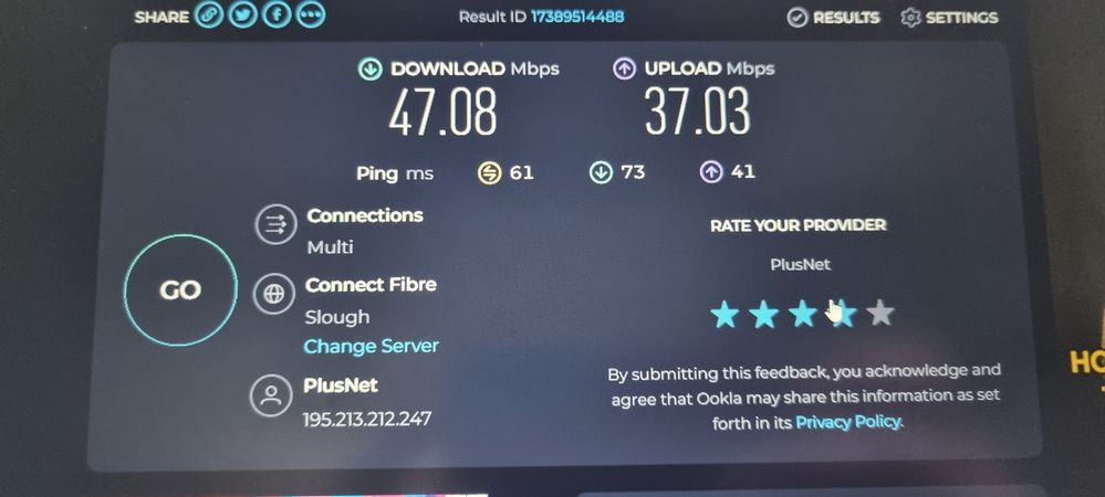

In contrast, the wired connections are not good at the moment - attached below are two laptop tests which plugged directly into the router by wire. See below. 30 or 40...?? Note that 4 hours ago (my earlier post!) I was getting 356mbs....!
On my powered line I am getting barely 20 at the moment. I would expect them to be 100 plus at least - 150 ideally! I understand what you are saying about me potentially 'not noticing' previously but I have been gaming and streaming for years and never had any issues as I was getting 50+ speeds on my old connection - I notice anything that makes my game stuff laggy, spikey and unplayable! Yesterday my wifi wasn't working and now my wired is so slow - this is so frustrating.
I have just ordered a 20m cable to connect my main PC directly to test this further.
Any other ideas are welcome. Thanks!
Posts: 19,672
Thanks: 8,712
Fixes: 567
Re: Wifi 'connected without internet'
I suggest that when that arrives you disconnect all the powerlines and test with just a single direct wired connection
