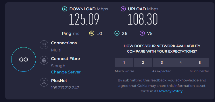

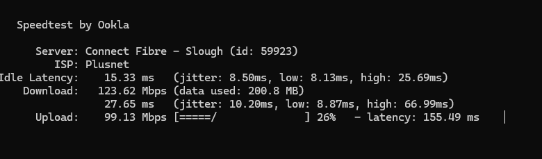

Can you post the results of a speedtest using the Ookla speedtest https://www.speedtest.net/ using a wired connection ?
If you have the FF900 product then I'd suggest using the cli version https://www.speedtest.net/apps/cli as it eliminates any browser dependancies and gives a more consistent result at the higher speeds

Wired tests - not directly into router but via TPL link... seems ok?
