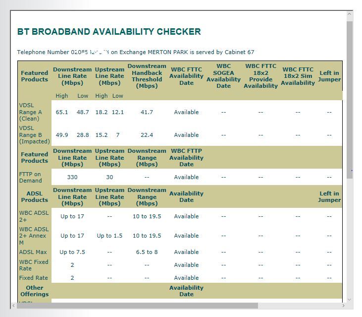

Super (I think) Thank you both... I'm cabinet 67 ![]()
Can someone tell me, from the data is this good, bad, average or other? ![]()
Its all gobbledegook to me. ![]()

You will be on the same copper from the cabinet as before. Whether it is "any good" is more easily guestimated by providing your modem-router stats, as the sync rate and SNRM values are a more reliable indication.

FTTC is VDSL as opposed to your old service of ADSL.
With the latter it is the distance from your house to the Exchange which matters - with VDSL it is the distance from your house to the Cabinet.
Look at the VDSL results for details on your line. It shows a "good" line (A) and an "impacted" line (B) which gives an indication of what speeds you should expect.. You don't say what your actual speed is.

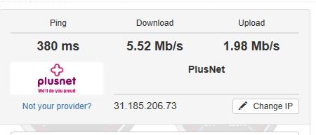

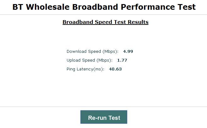

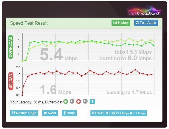

I just ran some speed test on my fibre broadband and the results are...
16-04-2017 7:53 PM
How are you running these tests, wired or wifi? And what are you using to test?
A copy of the sync speeds from the helpdesk tab of the troubleshooting area of the router would help with diagnosis.
Re: Which Green Box? Can I find out? Does it Matter?
16-04-2017 9:17 PM
@Mustrum wired to a Windows 10 desktop PC.
I just did the whole checking system and found a microfilter might be part of the problem as when replaced it went from 5mbps to 20mbps, which is what I normal get on my line (up to 35mbps).
I think I will replace all the microfilters tomorrow.
