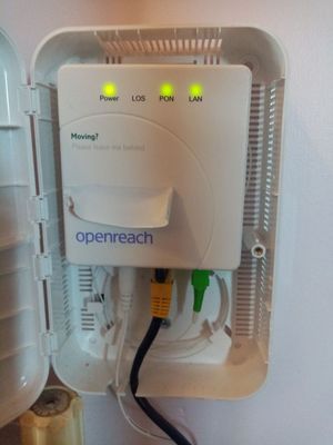

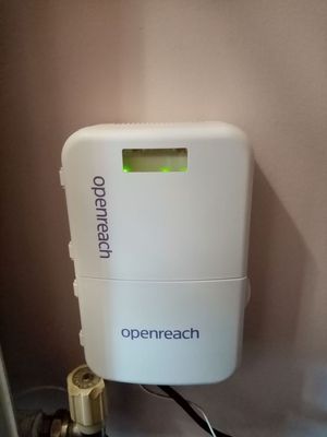

23-11-2025 3:14 PM
I meant to follow up on my last post.
It the duct is continuous from the Chamber to your Master Socket then it's possible the installer could rod the duct and pull the fibre cable all the way inside. It would then be finished with an internal CSP beside the ONT.
The first picture below shows an install similar to yours. The box for the CSP uses the original MS box and you can just see the spare fibre optic cable would round the fittings.
The last picture also shows an internal CSP whiere the cable comes in through the wall from outside.
