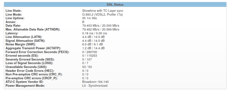

I am currently subscribed to the Unlimited Fibre Extra package, receiving download and upload speeds of 79.4 & 11.1 Mbps. This is achieved with VDSL2 profile 17a.
If possible, I would like to increase my upload speeds since I regularly upload large files (compressed archives >= 1GB) for work. Given than I live <150m from the local BT exchange, would there be any benefit in upgrading my router to support the 35b profile? Does Plusnet support VDSL2 profile 35b?
I have checked my local BT exchange (https://www.broadbandchecker.btwholesale.com), and it seems that the upload speed is capped at 20 Mbps. I'm unsure whether the DSLAM supports VDSL2 profile 35b, but the 20 Mbps cap would suggest not. In any case, my current upload speeds are 9 Mbps slower, possibly due to Plusnet throttling the connection.

@osian-dafydd  Openreach VDSL2 which Plusnet supply uses Profile 17a. There is no way that can be changed so upgrading your router will do nothing for you.
Your upload speed is lower than it should be but seems to be suffering from a lot of errors.  Perhaps you should get Plusnet to investigate this.  Plusnet are not throttling your connection but the Openreach Automated DLM (dynamic line management) system could have reduced the speed. If you don't get a staff response try raising a fault online at  faults.plus.net

Your upstream speed ab
nd SNR suggests that you have noise in an upstream band of frequencies.
Have you run any diagnostic tests like the quiet line test, testing from the test socket or using a different filter?

I have just performed a couple of tests. Changing the filter made no difference, however connecting to the test socket has solved the issue:
My modem is now showing 20 Mbps upload. I guess the telephone extension is faulty.

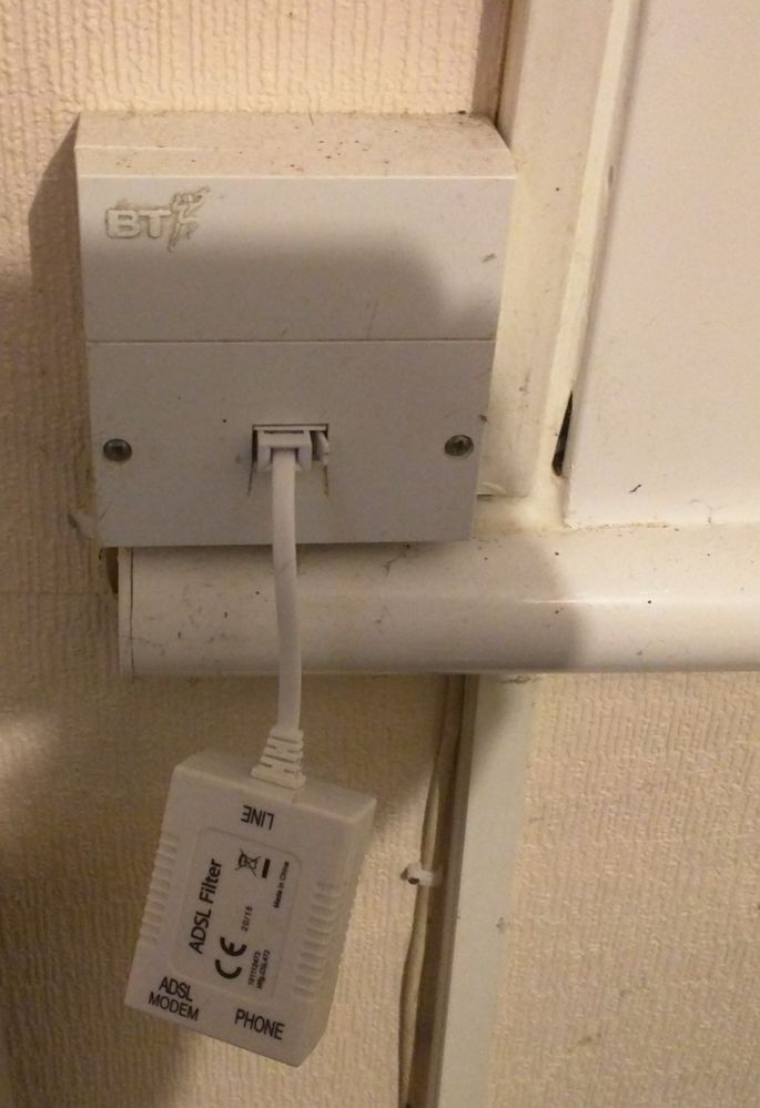

Hi Dan. The master socket only has a telephone line connection (no RJ11). I normally have nothing plugged into it. This is what it looks like inside:
The telephone extension connects through the back of the box. It runs ~ 6 metres into my office. From there, I connect the modem:
Thanks for your help, Osian.

@Baldrick1 Thanks for the suggestion. I'll give it a try. I considered changing the faceplate some time ago, but I quite like having my telephone & networking equipment all located in my office.
@bmc Yes, I regularly use a landline in my office. Here is a photo of the wiring inside the master socket. I'm sorry for the rather dark image!
This wiring was done years ago. I guess the extension line is probably 20 years old!

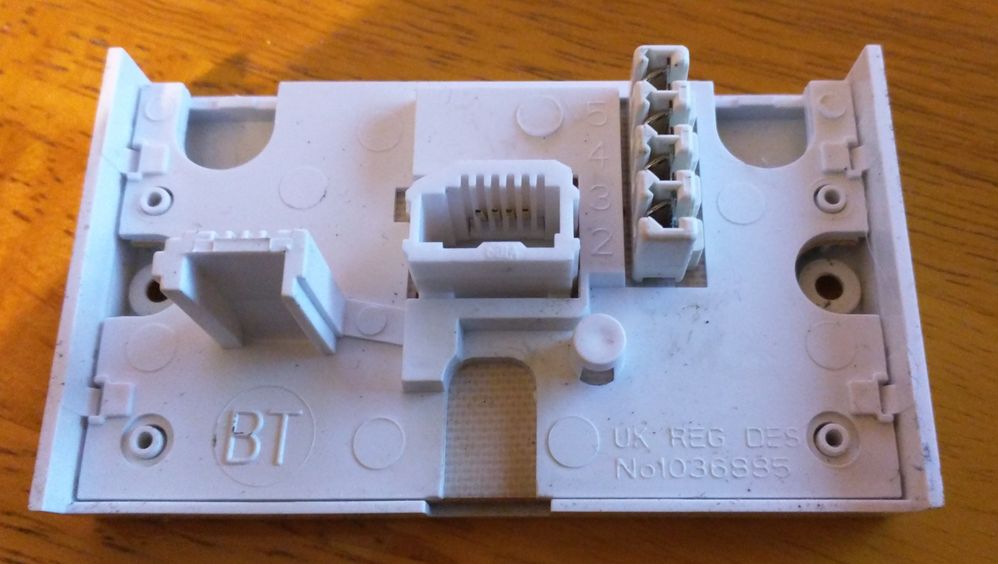

Then, if desired,replace your current extension with a new socket. If possible perhaps even replace the wiring with new high cable cable if accessable.
You'd still need to plug in a filter but simply replacing everything might well have the desired effect.
Any chance of a picture of the inside of the extension? I'd like to see if there are 2 or 3 wires attached. Removing the Bell wire has been proven to improve performance (it can cause interference).
