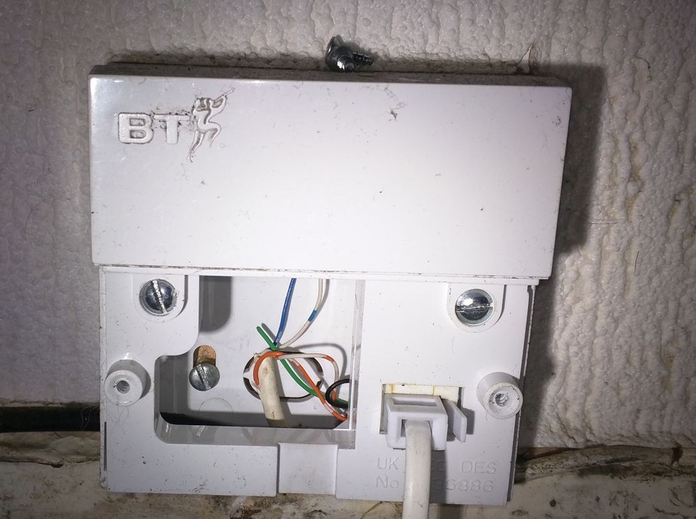

Hi Dan. The master socket only has a telephone line connection (no RJ11). I normally have nothing plugged into it. This is what it looks like inside:
The telephone extension connects through the back of the box. It runs ~ 6 metres into my office. From there, I connect the modem:
Thanks for your help, Osian.

@bmc Yes, I regularly use a landline in my office. Here is a photo of the wiring inside the master socket. I'm sorry for the rather dark image!
This wiring was done years ago. I guess the extension line is probably 20 years old!

I had looked at the instructions believe it or not. I had already re-read them and was going to re-post. If you use the B & A terminals for the extension does this send a filtered signal only? If so, then there's no phone line. If it sends both then you still need a filter on the extension. Or have I got this completely wrong?
I agree it's not ideal to run the Router from the extension but given the incoming speed and the short distance (6m?) to the extension I don't think you'd lose much performance.
Finally, from looking at the last photo there could well be an orange "Bell" (or Ring) wire connected.

Any chance of a picture of the inside of the extension? I'd like to see if there are 2 or 3 wires attached. Removing the Bell wire has been proven to improve performance (it can cause interference).
