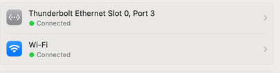

What's the order of network connections in settings?
If you're using ethernet that should be first e.g.
macOS will honour that and only use WiFi for things like Find My

Yeah - thanks - the ethernet is definitely first and that's definitely the connection that's being used most or all of the time.  I just wondered if maybe the OS was just occasionally sending some packets down the other one just to check it's quality - i suppose that can't be how it works.   Or maybe some other weird intermittent interruption triggering some use of the wifi - presumably if the ethernet dropped then it would switch to wifi?   There's also a corporate VPN (but I think it's split so I don't think it should be affecting the Zoom traffic) and a Trend Micro Content Filter VPN.  So there's all sorts of complexity in the setup, I guess.
