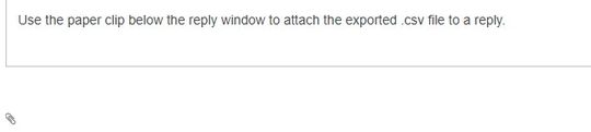

Use the paper clip below the reply window to attach the exported .csv file to a reply.
