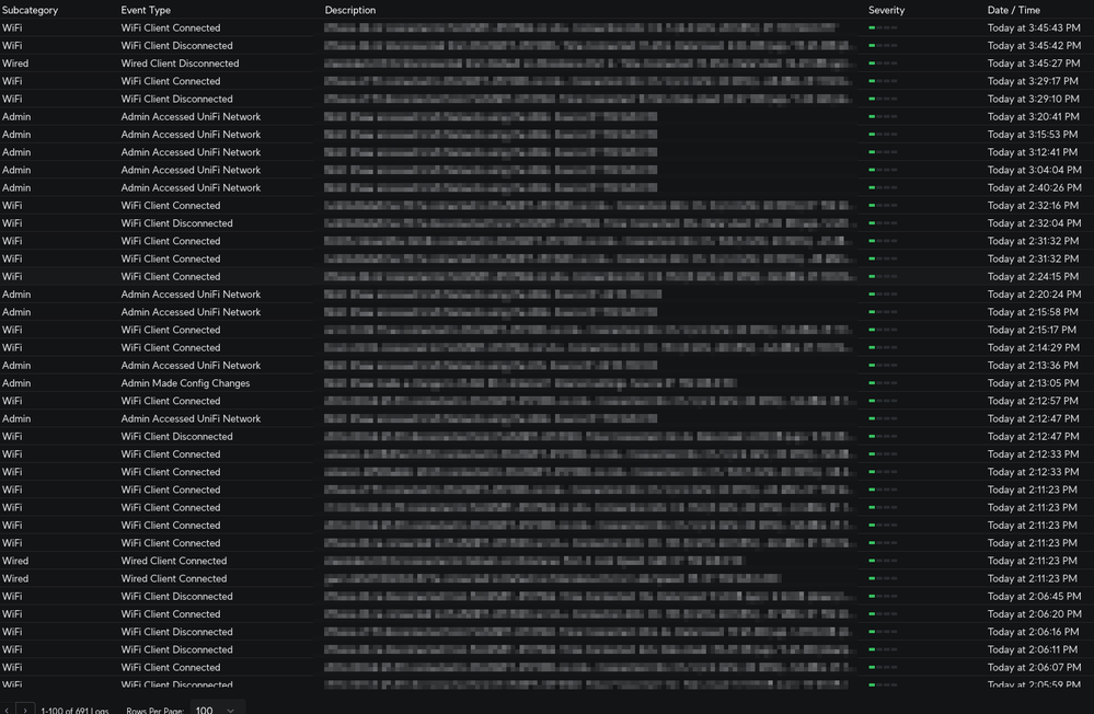

09-02-2026 7:06 PM
this is the settings for pppoethis is the logs out put and there is nothing to do with pppoe

its now working i looked in to the logs and watching them live its now fixed
