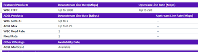

Is this   Screenshot 2022-07-31 075904.png what you are referring to?
They are not the same product.
Dan.

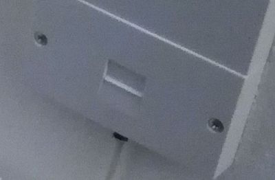

With an overhead feed OR replace the current copper cable with a fibre one (to reduce strain on the pole) so there would be no going back. However, copper tends to get left in situ with underground feeds with the fibre cable being run through the same duct. With installation, they can come in via the existing copper entry point with the fibre cable dropping from the Master Socket before going to the Optical Network Terminator (ONT). This is about the same size as a wall mounted master socket.
If not possible this way a hole would have to be drilled which might give you the option of a slightly dfferent location for the ONT.

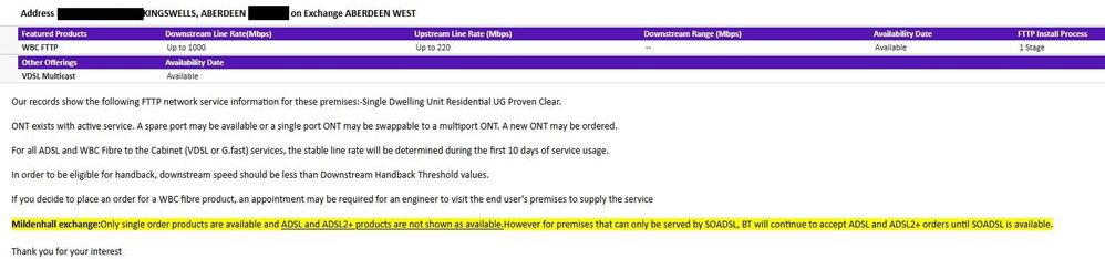

it'll probably show FTTP on Demand as well
My understanding FTTPoD is no longer available when WBC FTTP is, it wasn't offered on the address I checked
Dan.

Did a check on my address.
No FTTP on Demand shown as you suggested. No ADSL products now shown.
But perhaps the most interesting bit of all is I've now moved Exchange - I used to be Kingwells.

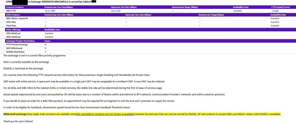

@Dan_the_Van
OK, even more interesting. The previous check was done using my address (no phone available).
I've now run it again using my UPRN code
I'm back on Kingswells Exchange.

@bmc  The address checker is only showing FTTP so Aberdeen West must be the Fibre Headend Exchange where all the fibre links in the area start from, in many cases this is not your local copper line exchange. The UPRN checker is showing the cabinet number on your local exchange. It's just the copper and fibre going to different places. At a previous rural location my head end exchange was in the nearest city about 14 miles away from the local exchange. You haven't moved exchanges.🤔
