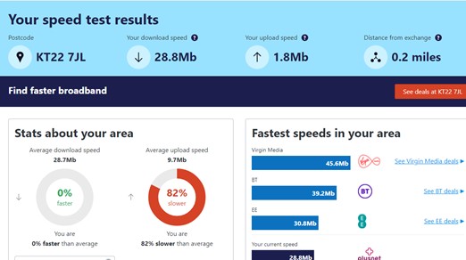

I had to make a new account to post, basically I am with Plusnet and I have been getting very slow upload speeds of a max of 2 mb/s, download is speed is strangely fine but upload speed is not.
I have come across a few posts with similar issues on this forum, is something going on?
Just to reiterate the steps I have taken, I have tested on both wired and WIFI connection and the results are the same, I often upload files and download music and it's taking ages to do this.
I have been using https://www.broadbandspeedchecker.co.uk to test the speeds which has never showed above 2mb/s the last 2-3 days. I have tried resetting the router normally, factory resetting the router and going into advanced options inside the plusnet router options and changed channels as advised by someone I spoke to on the plusnet team but this hasn't resolved the issue. Any ideas or help would be much appreciated.

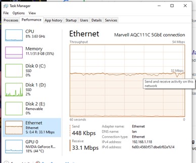

Thanks for your response, please see relevant screenshots/attachments as advised.
Hopefully you can see some of the info and I haven't missed out or left in any personal info in there. Weirdly enough any of the advanced/diagnostics couldn't find any issue with the upload speed but my devices all seem to be struggling with uploading/downloading from the internet. Music files for example are taking a long time to download and updates also taking a long time.
Let me know if you need any other information or if I have missed anything. The BT speed tests seem to indicate everything is okay but I know there is an issue as I am still struggling and getting low upload speed results on broadbandspeedchecker.co.uk.

Thanks for the details, Alex. Taking the shots in order:-
The Basic Speed Test looks low on Download, but OK on Upload.
I'm not convinced the 'Broadband Speed Checker' is accurate, going on the other reports.
The BTW Performance report (dated 11/10) looks healthy.
The BTW Speed Test report (PDF) mirrors the Basic Speed Test'
Your Help Desk indicates you  have had a recent re-sync, which could indicate a network problem - and also be part of the reason for your poor upload performance.
