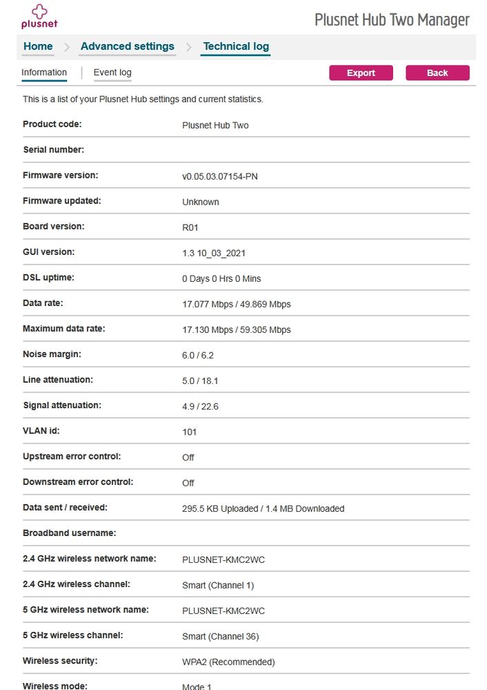

Hi, I've just done a factory reset on the router as you mentioned, made no difference, here are the router stats:

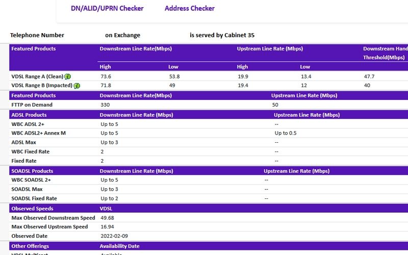

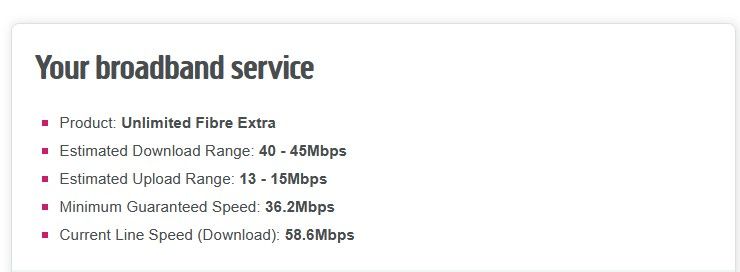

Another little twist in this saga, after a Openreach visit last week, them being very happy with my line and saying I should be syncing faster, along with Plusnet who basically said the same. Seemingly a last resort move was for my "profile" to be changed on Tuesday. Since then, nothing has changed apart from on the Plusnet website, it is now saying that my minimum speed is 36.2 from 43.4! I'm trying to be positive but of course this looks like to me the "goal posts" have been changed, doing me no favours at all, something I'm obviously not happy with.
This today's figures, I'm still actually connected at 49mb and have been since I have asked to reboot the router, in fact the same speed since the day I joined Plusnet (24th Jan) I don't think DLM has ever been active.

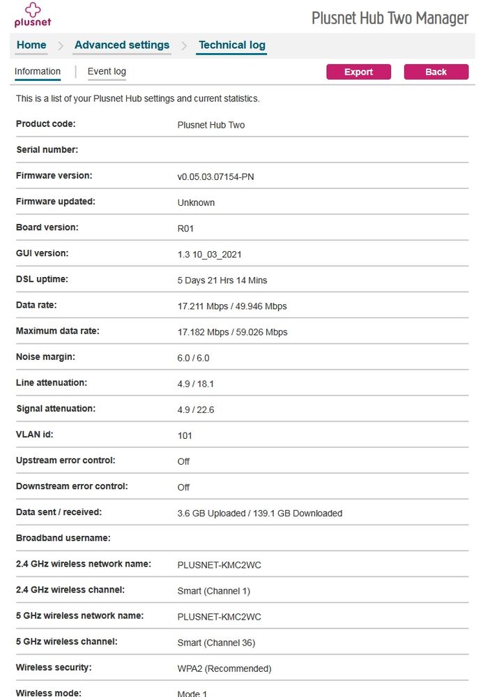

This is my latest check (Today).
Latest Router stats:
I'm just hoping all of this can be sorted at some point.

As discussed in our earlier conversation, please disregard the speed estimates on your Member Centre for now, since we changed the way in which speeds are calculated back in November last year, we've found that both estimates and minimum guaranteed speeds are changing on our customer's side, depending on how the line is performing at that given moment. As discussed, we'll always use the initial estimates you were provided with, along with the initial MGS, when investigating faults on the line, which can sometimes lead to a conversation being had about the contract.
In terms of your connection speeds, we did estimate your speeds to be between 48 - 66Mbps, and the line is currently syncing at 49.7 Mbps. I'll attach a graph to this post which also shows that the sync speed has remained constant throughout your time with ourselves.
