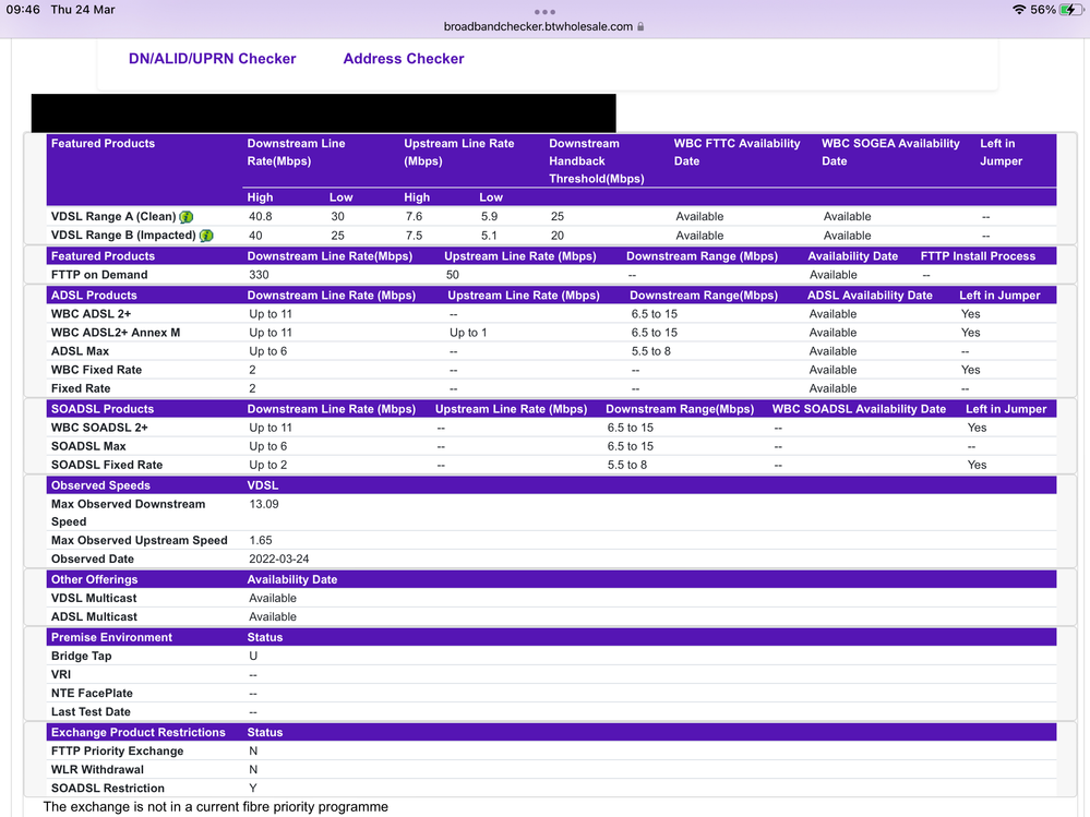

Re: Slow speeds

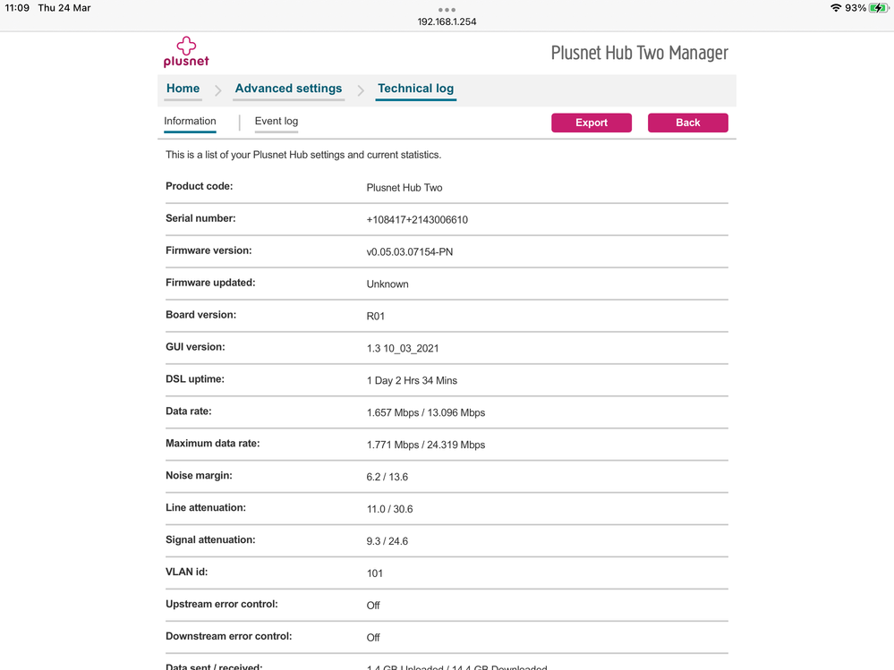

Re: Slow speeds
A picture paints a thousand words:
HighHopes
Posts: 8
Registered: ‎24-03-2022
Re: Slow speeds
Posts: 25,181
Thanks: 9,103
Fixes: 387
Re: Slow speeds
I would report a fault at https://faults.plus.net
