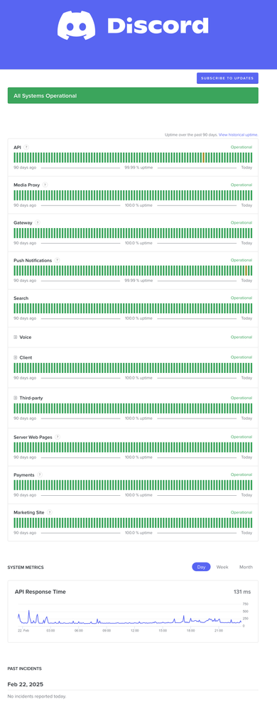

Re: Slow connection - anyone else?
@Chris01 wrote:
Also Discord having issues at the same time
Errrmm, Nope !
Checking  https://discordstatus.com/  it says "No incidents reported today."
nbk
Posts: 132
Thanks: 4
Registered: ‎06-01-2015
Discord is hosted by cloudflare and it's plusnets routing to cloudflare that is the problem at the moment therefore there's issues connecting to discord.
