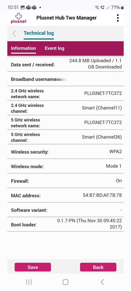

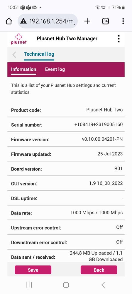

@Rshep20 Can  you please post a screenshot of your router stats?
For the Hub Two -
Obscure your username.

@jab1
If this is Full Fibre then I would suggest the router stats are not going to reveal anything about the connection, just confirm the WAN connection speed which should be 1000Mbps and the connection up time.
A speedtest might be more helpful
Posts: 23,792
Thanks: 8,448
Fixes: 357
Re: Slow broadband and work VPN keeps dropping out
@Dan_the_Van Agreed - however, I see many people posting saying they have 'Full Fibre' when they are actually on FTTC.
Rshep20
Posts: 6
Registered: ‎26-07-2024
screenshots as requested
Rshep20
Posts: 6
posted screenshots
Posts: 23,792
Thanks: 8,448
Fixes: 357
Cheers, @Rshep20 - so you are on FTTP - @Dan_the_Van 's suggestion of a speed test - use Speedtest.net - The Global Broadband Speed Test  is valid.
