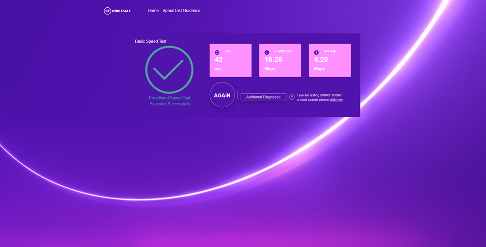

Screenshot 2021-09-04 at 20-30-24 BTW Performance Tester.pngScreenshot 2021-09-04 at 20-31-55 Broadband Member Centre Plusnet.png
My current line speed is below the minimum guaranteed speed and i have multipul saved speed tests from 2019 and 2020 of my download speed at 38 Mbps and even as high as 44 Mbps

Re: Slow Speed / DLM reset
As you say, your current line speed is below the guaranteed minimum, but we need to discover why. Sight of your Help Desk tab from the router would possibly give us some insight.

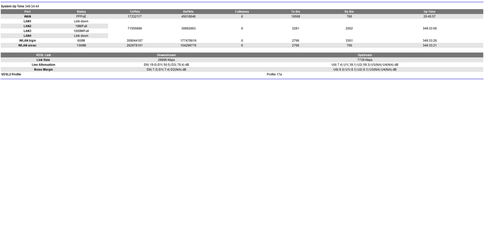

i dont use the plusnet router, what infomation would you like to see?
Which router do you use? We really need your router statistics - Noise margins &c.
Something is definitely a bit flaky there, but I can't work out what. Did you spot @Mustrum 's edit asking for details of the BT Broadband checker?

Hello @cgordon
Thanks a lot for reaching out. It appears that on 21/08/2021, the line cut out 52 times, there's no way of knowing introspectively why, but I can see that DLM did slow the line down, and capped your download speed to 30Mbps as a result of this.
Going forward, I've raised this issue with my colleague, who will be requesting a DLM reset with our suppliers, please allow around three working days for this to be completed.
Current profile - Downstream: 0.128M-30M with Retransmission (High). Upstream: 0.128M-20M with Retransmission (Low)
