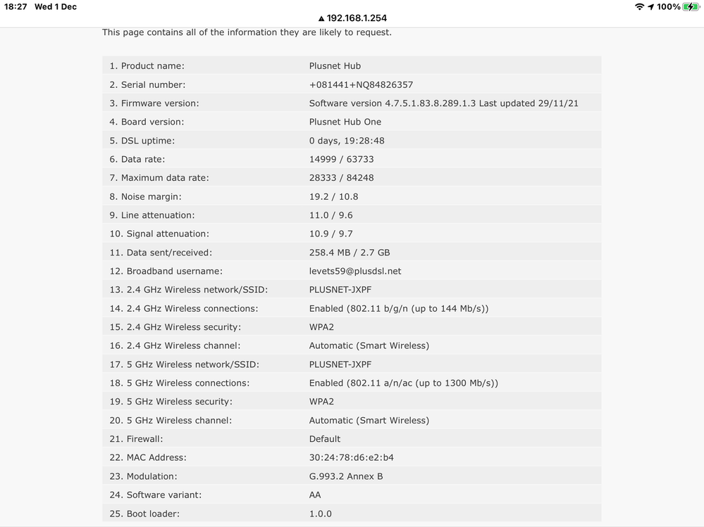

Welcome to the forums, @levets . When you say 'dropping off', what exactly do you mean? Are you able to post a screenshot of your Hubs Help Desk page and one of the WAN tab of your Event log, please?

Hi, hopefully I’ve done this correctly.

Yes, both pictures are useful, thanks. The Help Desk indicates you have only been connected in this session for about 19 hours, and the event log, which looks a bit strange, but is helpful indicates you have been losing connection and reconnecting - at least a couple of times late last night. I suspect there is more disruption, but obviously can only see what you have been able to provide.
From that, I'm sorry to say there is little I can usefully advise - I'm not PN staff, but hopefully one of the Help Team will pick this up soon and (hint to HT staff 😉) provide a Radius log and GEA test to show the issues.
