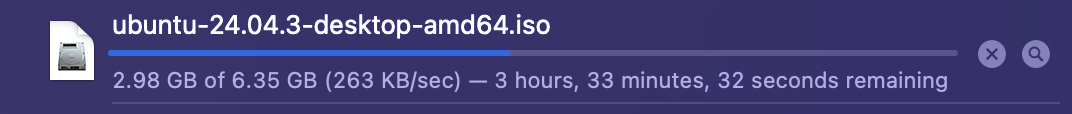

I'm on full fibre 300, but I have never experienced anything about 24Mbps. But that's not really the problem, the problem is the performance is very spiky. Sometimes it feels fast, other times it drops out - it cannot be relied on to hold a Zoom call open.
Attached an example of the performance suddenly dropping to 263KB/s.
How can I submit these observations to PlusNet?

@MattRocks That specific example could be due to the source being slow, but what do you  get on a speed test from say, Speedtest.net or the ThinkBroadband speed tester?
If those don't give a reasonable result, report your issue via:https://www.plus.net/help/report-a-problem/

Note that you are reporting inconsistent units…
  • mbps - BITS
  • kBps - BYTES
The 263 figure has been quoted as both B and b - B is at least 8b.
This is most probably a WiFi problem, not a FTTP issue.
