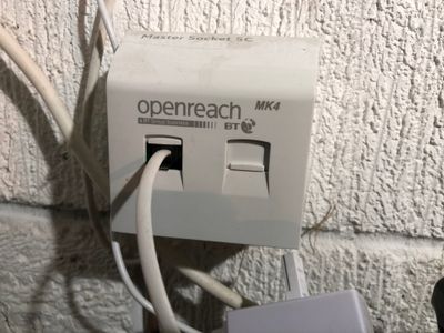

Yep all checked and seems fine. We have a master socket with 2 sockets and the router is plugged in directly with a short patch lead.

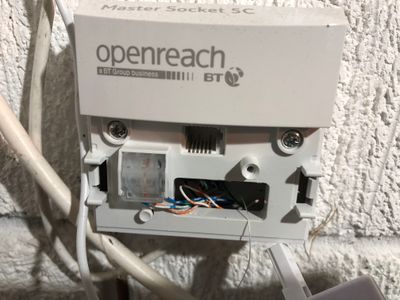

Thanks Jayne, could you try plugging the router into the test socket behind the bottom half of the faceplate?

Sorry no, I can't connect to the plug under the front face plate as there is no RJ11(?) under the plate; there is only a normal telephone socket. The cable from BT wall box to the router has RJ11(?) at both ends.
The only way I could make the connection to the socket under the plate would be to use a microfilter as an adapter; is that what you want?
Jayne

Yep if you use a microfilter you'll be able to plug the router into the test socket in the centre.
Let us know once you've done this.

Hi there, took a few mins for the router to obtain a new broadband connection but now seems ok. Connected to the master socket under the front cover via a microfilter.
