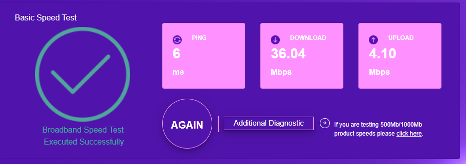

@Gandalf Success! After further investigation today the engineer discovered that the pair running to my house from the box was bad - he switched it for a good pair and speeds are now the best I've ever seen them (36Mbps - double what I was receiving a few days ago).
Fantastic service from everyone I've dealt with at Plusnet and Openreach, and a better outcome than I had hoped for. Huge thanks in particular to Prem the Openreach engineer, who was extremely knowledgeable, diligent and patient, and ultimately managed to solve the issue. Thanks all!

Re: PlusNet fibre: speeds much lower than advertised/guaranteed (HG612/Edgerouter X)
Ah, and here's the money shot...
