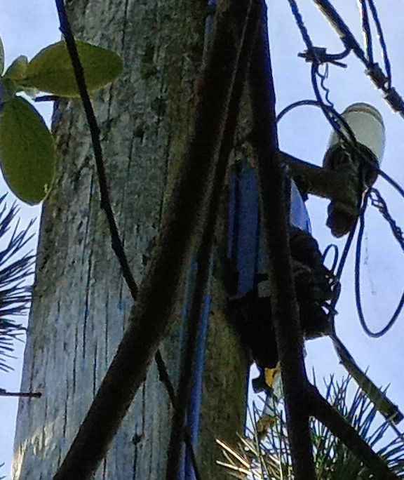

Just as a thought is there an OR box attached to the top of the pole that serves your cottage. This is the CBT (Connectorized Block Terminal). The fibre optic cable plugs into this before being run to your house.
Re: Overhead cable - how will the installation be carried out. Sorry more questions!
3 weeks ago
Router in the loft is not an option, I'm in my 70's and past running up and down loft ladders to get to it. It needs to be easy access. Wifi would be blocked from the bits of the house it reaches now, and I have dect phones to plug in so that cable would have to go up, and extra wifi run back down.
OH thinks a ladder from the patio should avoid the flat roof issue.
Theres only been phone and adsl on that pole to date but I tried to get a shot of the box up there. The trees are due to be trimmed, in fact scot power were supposed to be doing it last week.
