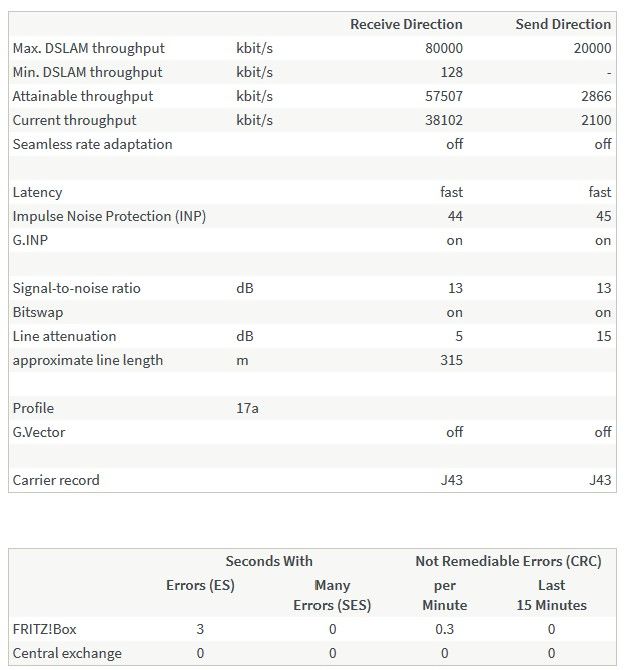

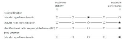

  4. I've kept the SNR settings as were suggested in the other topic that @RichardB linked to:
  5. The current SNR is reported as 13dB. Not sure if that is an unusual value?
Here are the current DSL stats:
Maybe someone with more knowledge can spot anything out of the ordinary in there?

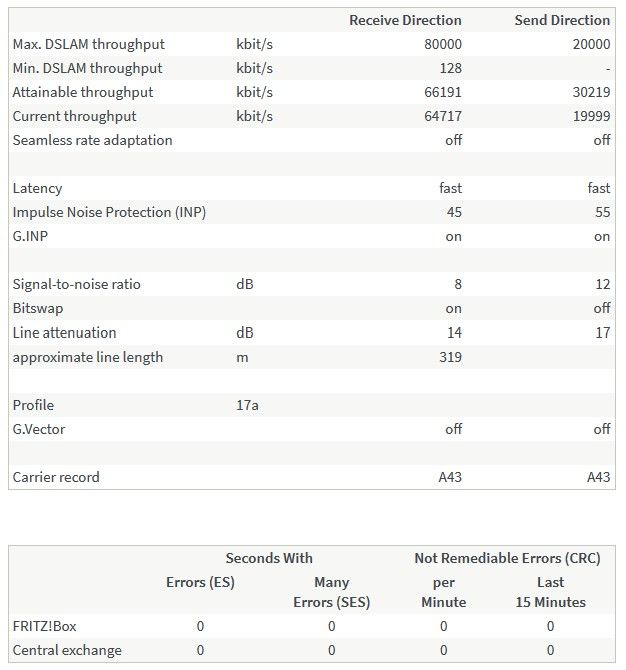

It now looks like everything has gone back to normal overnight:
64Mbit/s down and 20Mbit/s up are the kind of speeds I was getting before.
And it looks like the number of errors reported has also gone down.
It did lose sync twice between last night and now, but it seems to have reconnected again immediately after.
So for now I won't reopen a fault report ticket and I'll monitor the connection over the next few days to see if it stays stable.
