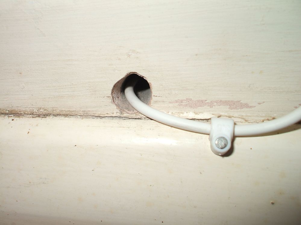

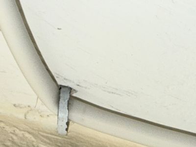

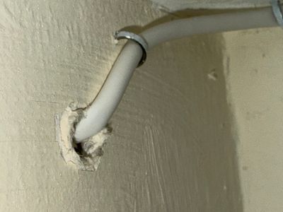

@iZian wrote:
@MisterW  it's definitely fibre; I saw him stripping the black "outdoors" protection off it when installing.
Outside it has its black coat on. Inside it's this white cable that runs to the ONT and has a green end to it plugged in next to the power and the cat5e cable that runs to the hub 2.
Outside it runs down to the grey box at the front of the house and that's it. I'm 100% sure it's the fibre, when installing he wanted me to check it was not "kinking" as it was being pulled through.
I only have a tape measure but the cable looks to be about 4mm thick... I zoomed in a lot...
If that's internal optical fibre in the photographs then, particularly the first one, definitely doesn't look right to me!
I have only a very short (couple of inches) run of internal fibre to the ONT. Using a ruler it is 3mm thick and here is a photo of it entering via a hole very much larger than the cable: DSCF1285.JPG

@MisterW wrote:
@iZian well to me, from that 1st photo showing the cable entering the hole, I would say that bend radius is considerably less than 30mm! .
I agree @MisterW , in fact I'd say the cable almost has a kink in it as the plastic looks bent/distorted rather than being smoothly curved.

@bmc mine looks like that except where it goes through walls it seems to be pulled very very tight against those metal hooks, and very tight against the edge of the hole in the wall, like it's squashing the plastic in both cases.

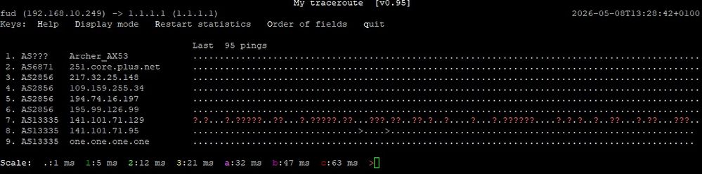

I've set up a new broadband quality monitor. I realised late I should have kept the old one since I can't "resume" it. rookie move by me. it's here https://www.thinkbroadband.com/broadband/monitoring/quality/share/682e35d655f43e4468781e9e53574931c7...
I've also enabled that firewall. So now I have a new trace route to cloud flare. New mtr route attached
I also can't speed test against BT as a result. Perhaps normal. it just errors. So I pick a new host.
I'll leave it running with firewall set to low. I've never had this switched on before. my ping seems to have risen a tiny bit.

@pvmb @RobPN just saw your replies; that's 100% my fibre cable.
But now I've turned on firewall I have a new "gateway" and new first hop so I'm going to have to see if that helps.
But yeah; I'd say it was ... squashed or pulled tight at a 85% angle... but ... the guy tested it and green lit it.
I wonder do I now wait a week to see if this firewall solved my issue or should I be concerned about these kinks anyway.
There are 4 to 5 of those. There's 2 walls and each one has 2 90º bends and there's one metal hook where the optical cable is very tight against to the point where I'd say it was digging in almost to the plasticIMG_9594.jpegIMG_9593.jpegIMG_9591.jpeg

Now were on the same network I can compare an mtr for my connection
It also includes the IP Address owner (AS Number)
AS6871 - plusnet
AS2856 - BT
AS13335 - cloudflare
Hopefully you are now using you broadband as you usually would.

@Dan_the_Van thanks for the compare. our first and second hops seem to be neighbours.
