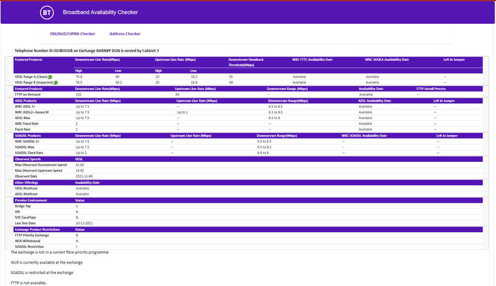

@DannyB73 Welcome to the forums.As you have cut your Help Desk report a bit short, what is the 'user name at line 12?
Also could you post screen shot reports from BT Broadband (obscuring your phone number) and from BTW Performance Tester  - the 'Advanced Diagnostics' report.
At first glance, I thought you were provisioned on a 40/10 connection, but with the U/S figure you must be on 80/20, and with Line and Attenuation fugures like that, you should be achieving 70+.

Hi, many thanks... please see below (I think I've got the right things!):
2021-11-18 16_34_22-BT Broadband.png2021-11-18 16_38_09-BTW Performance Tester.png
Posts: 24,887
Thanks: 8,923
Fixes: 382
Re: New-ish customer - Speed below minimum advised after 2 weeks
Yup, those are the correct shots, and something isn't right. You need Plusnet Help Team intervention.

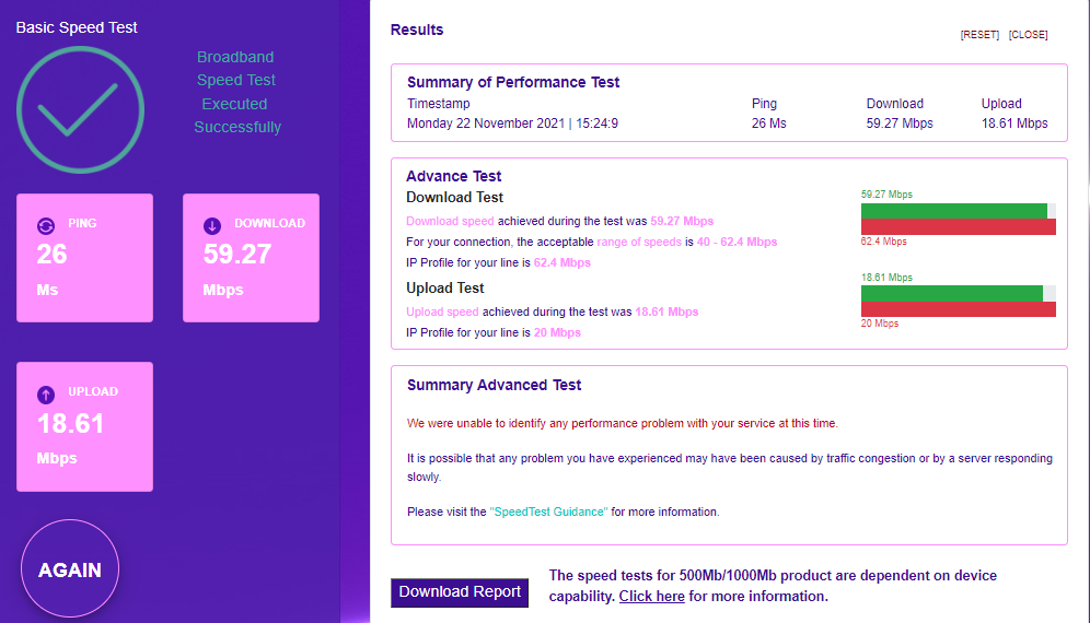

Many thanks to all that have assisted with this... Open Reach Engineer attended today and spent a lot of time troubleshooting the issue and changing things in the cabinet and at the pole. Download speed is now much better...
I'll update the ticket and monitor over the next 24 hours, but it looks as though my issue is resolved 👍
