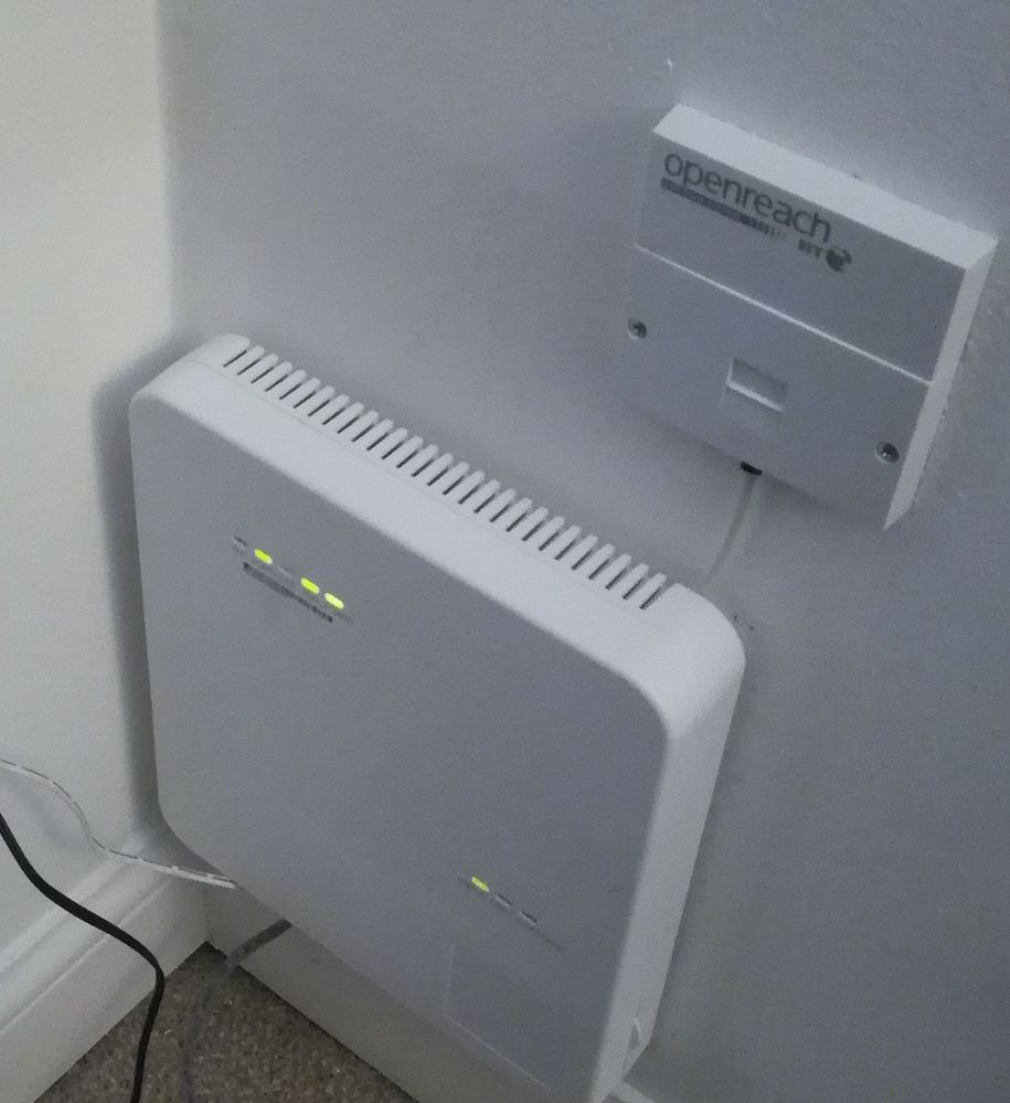

As a side question, when did BTOR start rolling out such tiny ONTs? The ones I've seen on YouTube etc. were massive - the one that's been installed is the size of a single gang UK socket and sits really nicely alongside my (to be activated) B4RN connection.
Re: New install, disappointing speeds - could/should I expect better?
11-06-2025 3:37 PM - edited 11-06-2025 3:38 PM
Can't comment on the smaller size ONT's but when I got mine in late 2017 I got a big 4 port ONT with a separate battery back up unit. A few weeks late a neighbour got the following installed. Can't remember if it's 4 port but still has the BBU.
