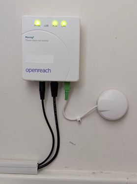

The new ONT are as small as you posted.

These are the ones I'm used to seeing but they are much smaller now (no BBU but I already have a "router UPS" which is happily running the ONT).

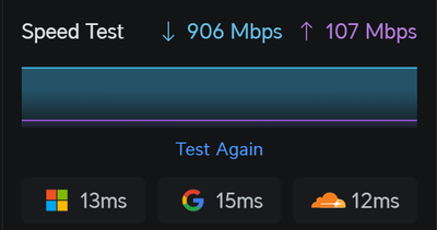

An UniFi's speed test;
I do not understand why running a test from the console itself is not returning exactly the same numbers that UniFi's speed test does - not even close.
