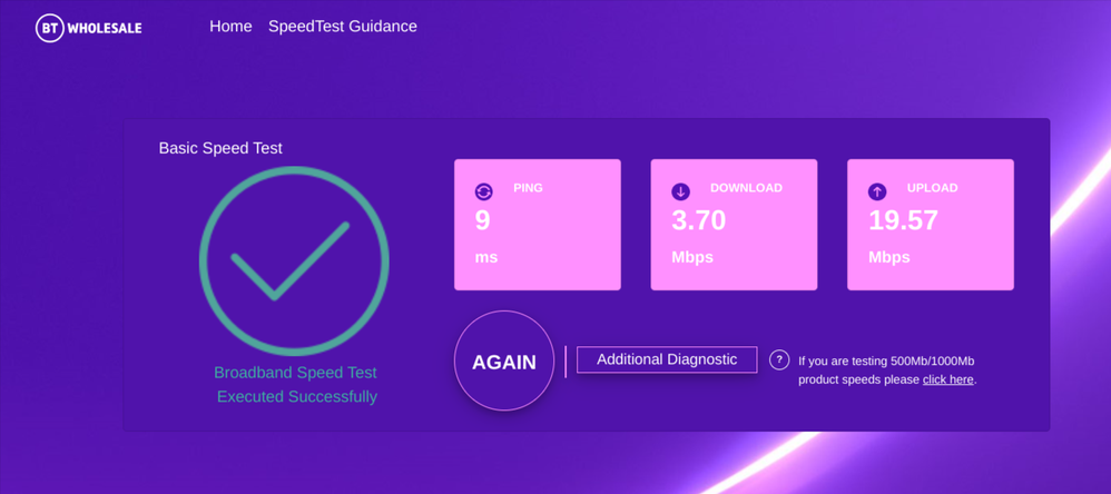

Upgraded to FTTP done today.
At the moment the download speed is less than 3 yes 3 Mbps. Upload is 19 Mbps. I used to get 45Mbps on the old FTTC.
Will it improve or should I ask the engineer to come back?

That does not make sense - did the installer not verify the connection was good before they left? Which port on your Hub is the ONT connected to?

The ONT is connected to the router WAN port as it was before. I never saw the installer carryout any tests.

Is this a wired test ? i.e device connected via an ethernet cable to the router

If you were previously on FTTC, you should not have been connected to the WAN (red) port on the Hub

no its from the laptop wifi, as before

The router is connected to the ONT correctly
@bikeman can you try a wired test just to prove whether its the connection or a wifi problem ?

He has simply changed the NBN ( I think thats what its called) for an ONT

Wired connection is same

@bikeman  so what connection did you have before ? and from which ISP ?
What router were you using before ? and what router now ?

Its PLusnet, hence me posting here. Heres the old box.
and heres the new
Both use same Hub2 router
