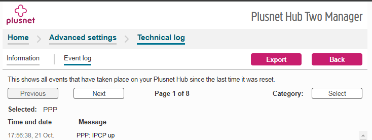

If it was me, I would be looking at the PPP event log of the Hub Two, this records the broadband user attempting to logon
The event log is found here
Change the Category to be PPP
You can either take a screen shot of the full page or export the file and attach the downloaded csv file

Sorry the link is http://192.168.1.254
Click on Advanced Settings >Technical log > Event log My last post shows what to expect

I don’t know why but the page just won’t load?
Posts: 4,971
Thanks: 3,272
Re: My router has broken
You need to be connected to the Hub two WIFI for the link to work, if there is a message about the site not being secure, accept the risk and continue
