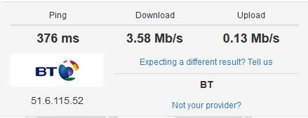

Having really big problems with my connection, at one point I was getting 32meg download and 10meg plus on upload now Download is barely 5meg and upload has flatlined completely. I'm now thinking of ditching fibre and going back to straight Broadband as I was getting a far better speed than I currently am.

Checked again and still rubbish

Hi there, I've just been looking into this and can see that the connection has been dropping fairly frequently, this is the most likely reason that speeds have been affected too.
I've just tested the line and have added a reply to the fault ticket on your account suggesting how we can move things forward.
