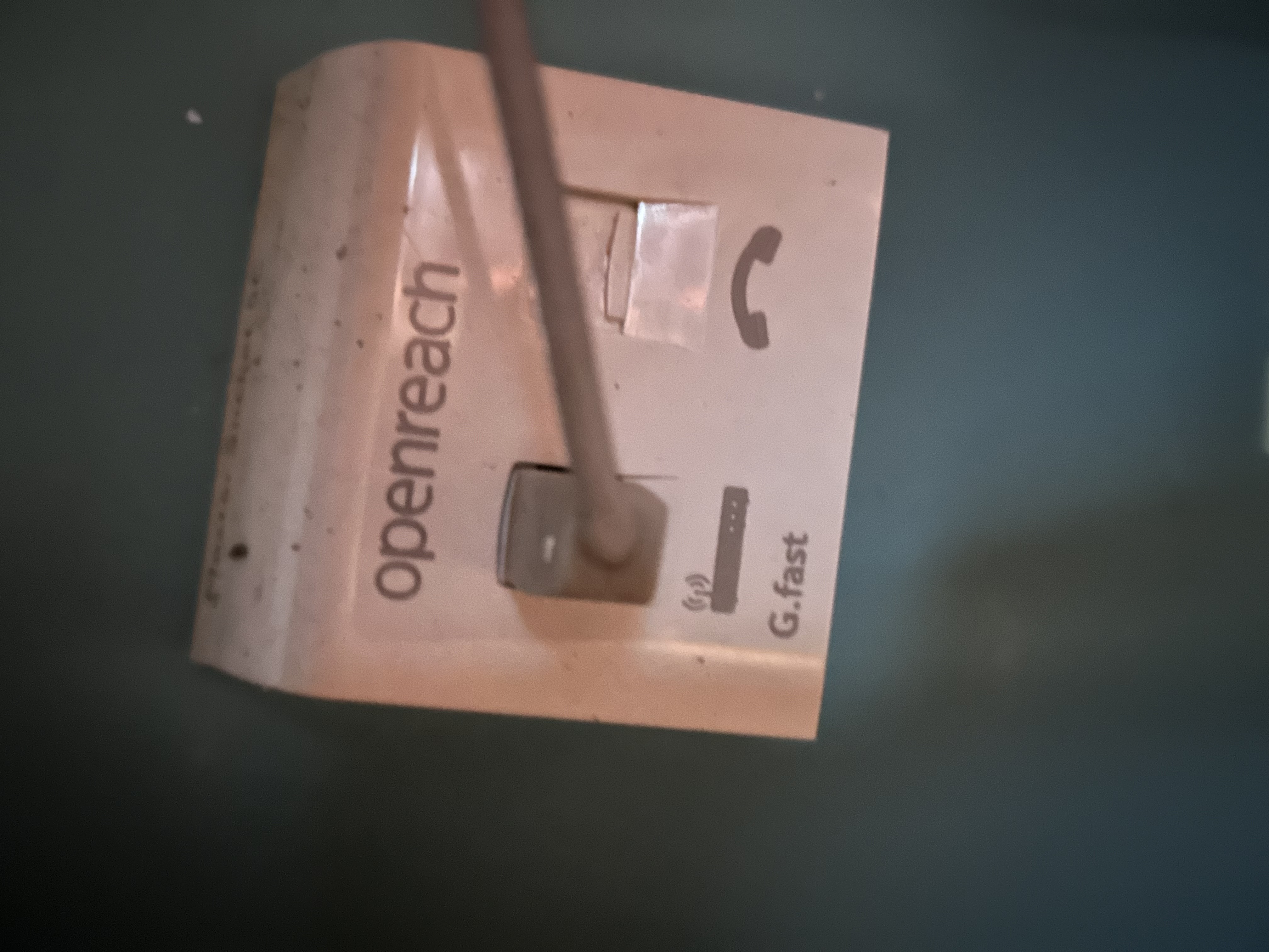

Actually, I was just wondering, could I just connect the new Cat5/6 up to the existing old port as in Pic or is that now totally redundant. It takes an ethernet cable
Re: Looking to Upgrade to full fibre- Worried about digging
yesterday
@Grother That master socket is not used with Full Fibre - at all.
yesterday
If you got yourself an ethernet port faceplate it may be possible to use the old back box.
From memory ethernet ports are wired with the cable coming in from below (plentry of videos online). You also need enough cable to wire the port before it goes on the box. It might be necessary to move the box up a couple of inches for cable access. Cover the existing hole with something like a Knightsbridge Modular Brush Flex Outlet White (Screwfix).
You could use the old copper cable as a "pull rope" to get the ethernet cable up to the study. What I did years ago was to buy a preconnected cable and then cut off one end to get the cable where I wanted before crimping on a new one. With ethernet ports all you need si a cheap "punchdown" tool.
