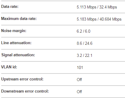

I successfully moved to Plusnet (from Sky) today, hoorah.
Router is all up and running but I can see that the banding issue I've been experiencing for more than a year now hasn't changed with the move.  Sky tech support was rudimentary and a DLM reset was never requested.
What I can see with the new router is that my line's max data rate is 37.7mbps, Sky chooses not to present this information in it's router interface.  I'm banded at exactly 32.4mbps, every reconnect, which as I say has been the case for over a year so I'm convinced the DLM band is stuck.  Perhaps the stability profile is incorrect/conservative too?
As a little bit of history, my line was originally banded down to 18mbps but after internal wiring replacement and a master socket change, it gradually crept up to the 32.4 band but stopped there.
Could a staff member please inspect my line/profile/banding?
Thank you!

Hi Adam,
I'm afraid no movement in the banding though DLM did do a few early morning reconnects with some improvement to the connected upload speed (+700kpbs) over the last few days.  The maximum data rate has increased upwards to over 40mbps and the noise margin which had some room to spare has settled down to the minimum 6db as the max rate increased (I think my cabinet is the brand that can't go to 3db).
Any suggestions or other avenues that could be explored?

Hi there, I'm really sorry that's still an issue, I'll pick this back up and make sure we get it sorted for you.
I've just been running diagnostic tests again and they've picked up on a line fault this time, on the up-side that means we can get that fixed by Openreach and it should mean that the issue doesn't return.
As you might guess we'll need to arrange for an engineer to come out and see you so I've added an update to your account here: https://www.plus.net/wizard/?p=view_question&id=223062207
Please take a look when you can, let me know on here when you've responded and I'll get it booked in for you.
All the best.

Hi Adam, the engineer finished up a little while ago.  He wasn't able to detect a line fault but did visit the cab to re-terminate the pair there.  That seemed to do the trick as the banding lifted and has allowed connection at a non-capped and higher figure.  A marginal improvement of 2.6mbps but every byte counts in this household.
Thank you once more for your help in this.
