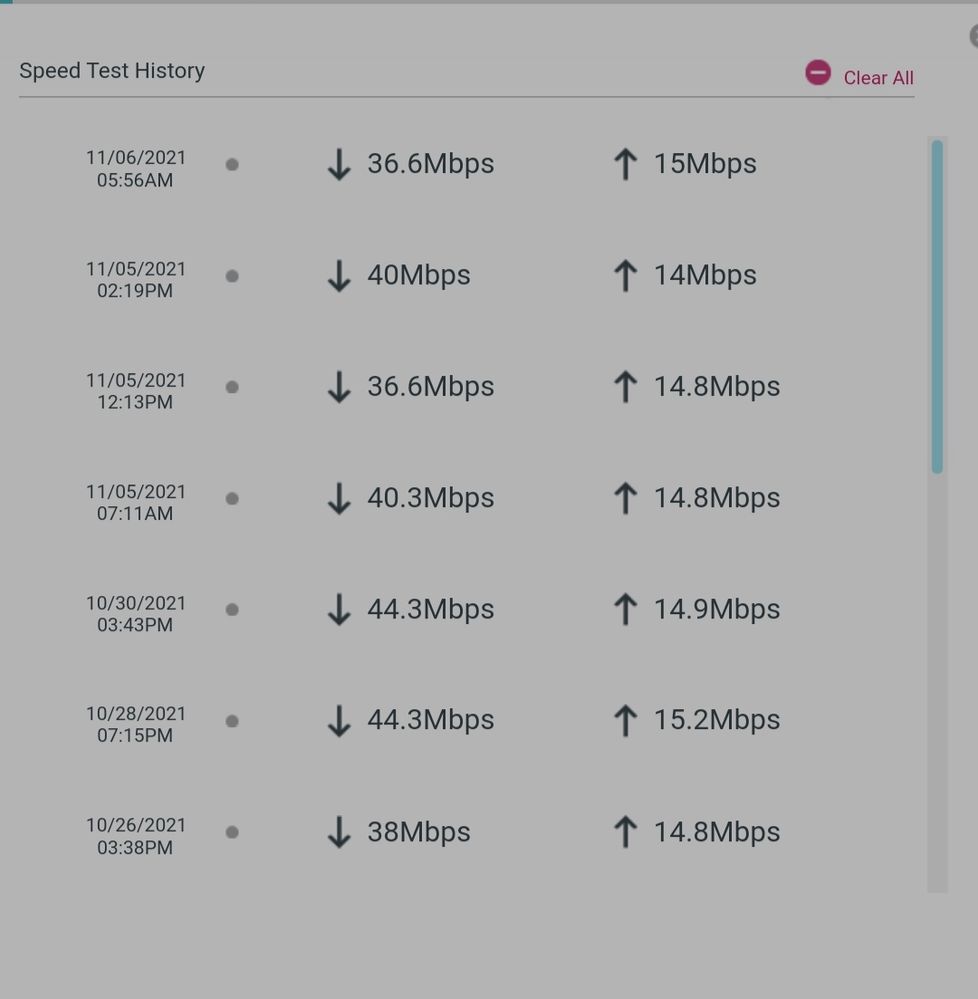

Hi,
I've been monitoring my line speed periodically, and have noticed the speed of from around 50mbps when first set up, to around 40mbps in recent weeks/months.
Is this something worth investigating, or will I likely just be fobbed off by PN?
Cheers

Re: Line speed reduced over recent weeks/months
The speed test is built into my router's admin page, so presumably the WiFi link is irrelevant as it would be from the router, not my wifi device?
Even so, most of these tests would have been done in close proximity to the router (like less than 5 meters away)

Hi @OhWell, thanks for getting back to us and I'm sorry to hear the engineer couldn't get to the bottom of the speed issue during the visit. His readings of getting 51Mbps download to his device however does bring to light there could be something out of place our side. Looking over your account further I can see that the speed profile set for your account looks to be around the 38Mbps mark which explains the 35Mbps seen your side. In which case, I've bumped this up to 55Mbps or where we'd expect to see it and if you turn your router off and back on your side you should see the normal speeds coming back through again.
Please let us know how this goes and if this resolved the speed issues you were seeing.
Hi Ben,
Looks like the change you did to the speed profile has worked, as I've just done a speed check which is now coming back at 49/14.
One question I have is should the speed profile not be set to 80mbps in-line with the 80/20 Unlimited Fibre Extra package, or is this changed to be closer to the actual measure line integrity check speed?
Thanks.
