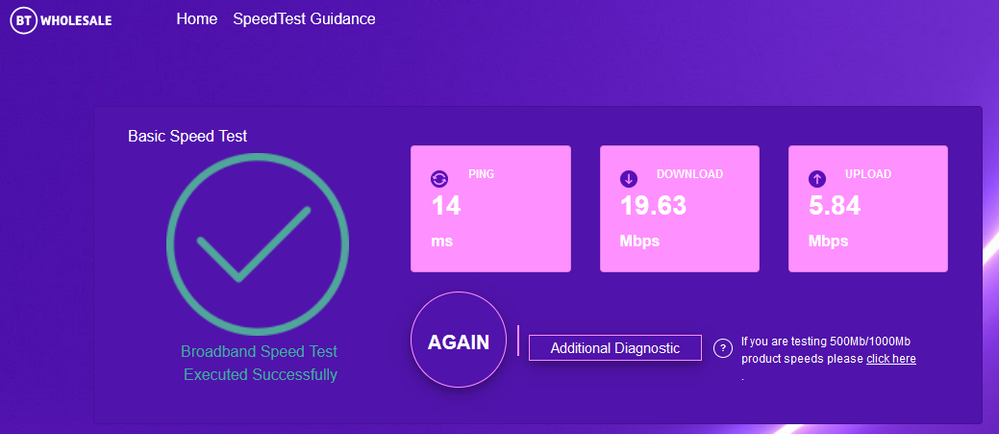

My line has just been reset and I am now syncing at 28477kbps but running a speed test shows a maximum download of 19.73mbps so it does look as if my Profile at PN needs a manual reset, please could someone reset my Plusnet profile.

I've increased the profile for you now. Can you turn your router off then back on? Smiley

Thank you I have Dropped the Wan and reconnected and all is now fine, Can anyone tell me why my Plusnet Profile does not automatically reset when my line Sync Speed is adjusted? Just interested to find out why it always seems to need manual intervention.
Speed BeforeBeforeBefore
Speed After
AfterAfter
