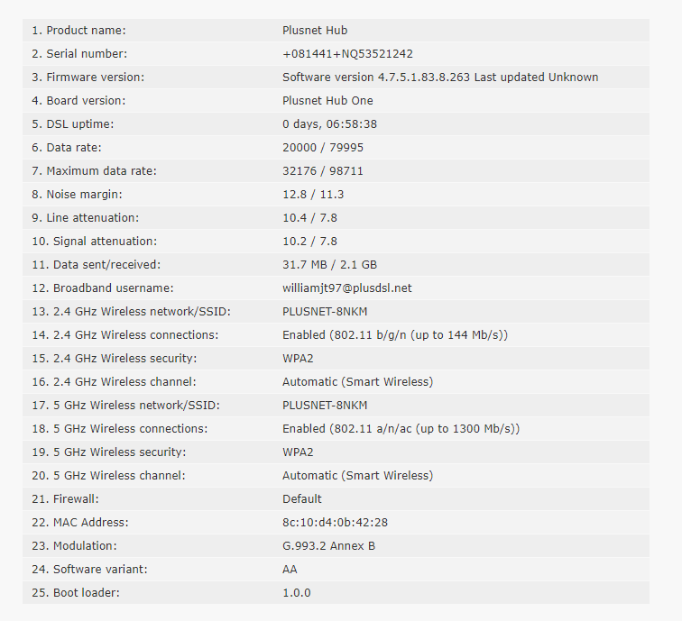

It may get picked up by PN staff fairly quickly, but just for my curiosity, can you post your routers Help Desk information?

Re: Internet connection disconnecting almost every day randomly
HcaFFZv
Sorry for the late reply - life got in the way. from that information, you certainly have a problem somewhere. Your D/S data rate is low, and your SNR figures are high. Is your phone line clear of interference -  dial 17070, option 2 - there should be no noise at all - if there is, report a PHONE fault first.

RealAleMadrid
Posts: 1,720
Thanks: 1,841
Fixes: 68
Registered: ‎07-07-2009
Sorry @jab1  but you have got it a bit wrong, the OP has a very short line to the cabinet and is syncing at full speed, that is why the SNRM values are high.  The data rate speeds are in Kbps so the modem/router is connect at 79.999Mbps down and 19.999Mbps up. I see no problem at all with the broadband connection, why it is dropping out is hard to understand. Need help from forum staff on this one.🤔
@williamjt97  Don't bother getting a phone, you have a perfect connection in terms of speed, I don't believe there is any phone line problem, the question is why is it dropping out.🙄
