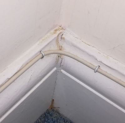

This is from my FTTP installation in late 2017.
Black external sheath was stripped back once indoors and then it was stapled round the skirting board.
